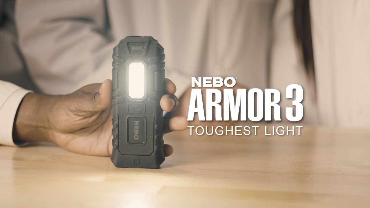

My favorite flashlight durability video. I have one of these. I don't doubt they are as shock proof as they claim - based on these two videos. The only downside - it's a pain to replace the batteries - you will need a screw driver.
Only a 14.5K pound fork lift could make it fail (partially).
I thought it was a joke at first the way they were talking. LOL!!! It does look like a good work light for working on a car or other things though.
