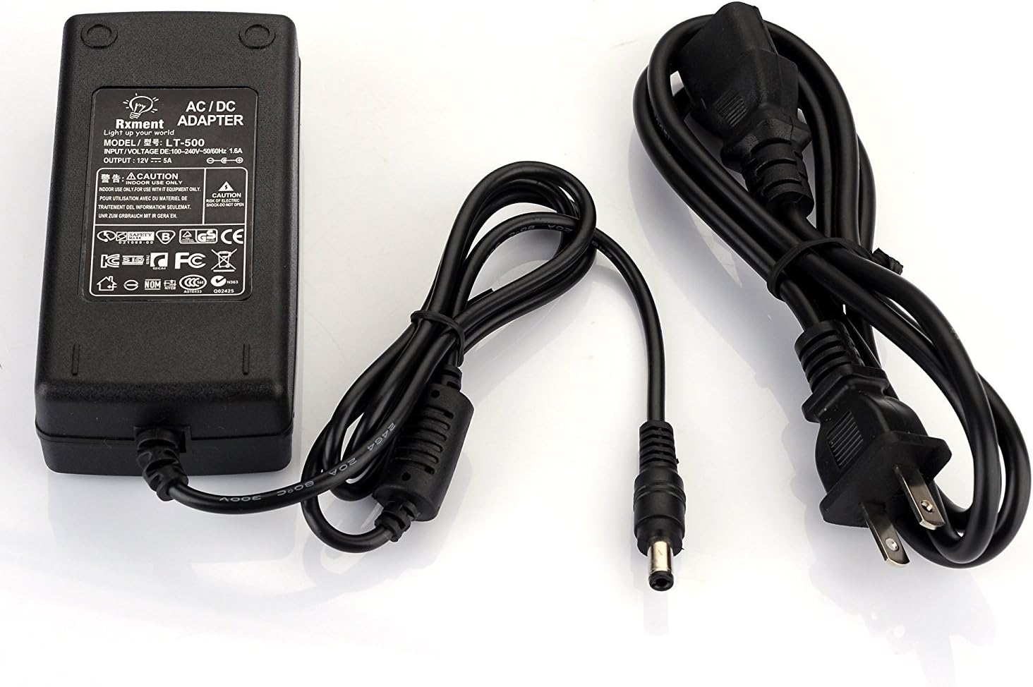

What do you use for a power supply Glenn?
Does it have to have the same specs as the one that comes with it or can there be some leeway in that??
I guess what I am “trying ” to ask is can one be used with more output and/or what are the limits and what should the specs be??

teacher:
Any help would be appreciated as I am in pretty much unknown/not understood territory. :person_facepalming: … …
Thank you in advance……… :+1:
I think I posted this before. I made my own 12 volt 5 amp power supply that does up to 4 chargers at the same time.
Edit: As long as the output voltage is 12 volts, you can use a power supply that has a much higher current rating. The chargers will only draw what they need.

i paid like 18 or 18.95 for mine from tomtop on one of their sales …for the charger and power supply .
Finding a 12V 2 amp power supply isn’t the easiest / or hardest thing in the world .
It kind of depends how crafty you are
The plug isn’t that hard to find either . i’ve seen tougher ends to find too i think it’s a 5MM with a larger barrel center pos…Don’t hold me to it but it’s not a weird one or overly difficult one to find .
14 seconds of digging thru my pile of junky wallwarts yielded a 5 amp laptop power supply 12v center pos. with the correct end and a 2.5amp/ 12v wallwart with the correct polarity and end so it’s not that hard of a one to find
http://www.ebay.com/itm/AC-DC-12V-2A-110-240V-POWER-SUPPLY-ADAPTER-CHARGER-FOR-LED-Strip-US-EU-PLUG-HU-/232217681238?var=&hash=item3611409d56:m:mBeLzKv8Ild1ViZlUgQBkmQ
nice price but buy at your own risk i have no idea if this one has the same / correct end on it …
Application: This 12V/5A power supply adapter is widely used for All LED strip lights type. Such as 5050,3528 type etc. Not only suitable for RGB LED strips, but also for single color LED strip. Like cool white, warm white and other color, etc. ...

I guess my questions are:
Will your set up supply all four chargers running at full power at the same time?
If I used a 12V 5A power supply with a single Lii-500, is what the charger draws from the power supply limited by the charger?
The Lii-500 comes with a 12V 2A power supply so it will not charger 4 cells at 1A at the same time will it??
But if I used a 12V 5A power supply with a Lii-500 could I charge 4 cell at 1A at the same time???
These are probably dumb questions, but it is what it is. :person_facepalming:
I’m not the sharpest pencil in the box when it comes to this.

teacher:
It's limited/controled by the charger.
It will. You are getting it wrong. Cells are not charged with 12V, they are charged with 4.2V so you have to look at the power (Watts), not A.
12V 2A is 24W, 4.2V 4A (1A*4 cells) is 16.8W. You could charge 5 cells with 1A using 12V 2A power supply.

XXX-Man:
teacher:
1~If I used a 12V 5A power supply with a single Lii-500, is what the charger draws from the power supply limited by the charger?
2~The Lii-500 comes with a 12V 2A power supply so it will not charger 4 cells at 1A at the same time will it??
3~But if I used a 12V 5A power supply with a Lii-500 could I charge 4 cell at 1A at the same time???
1~It’s limited/controled by the charger.
2~It will. You are getting it wrong. Cells are not charged with 12V, they are charged with 4.2V so you have to look at the power (Watts), not A
Thank you for the explanation ‘XXX-Man’, I think I finally understand. :+1: …
If power supply is 12V 2A = 24W // 12V 3A = 36W // 12V 1A = 12W // 6V 3A = 18W and so on .
V x A = W
So for instance, charging 2 batteries @ 4.2V & 3A each would be 25.2W.
Thank’s again ’3X’ ….

P.S.: I was told the Lii-500 works fed with a lower current (1A) supply, the thing just lifts off the foot from the gas pedal (0.5A charging, etc).

teacher
You get it :)
When dealing with different voltages we always have to look at the wattage (W) to know what is needed.
We also need to have some more W in power supply because charger is using some power for work.
