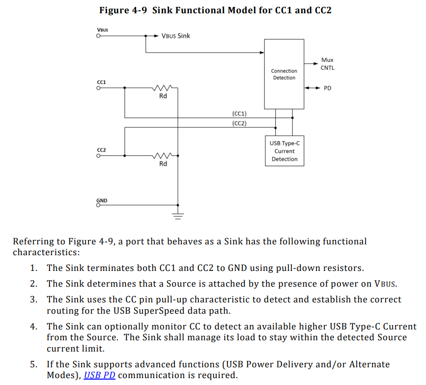

From what I’ve read, the other resistor types are used in the charger to signal to the device (power sink) what current the charger can provide. It is then the responsibility of the device to make sure not to draw more current than the charger supports. So by doing the simple/cheap fix of adding the 5.1 kΩ resistors without adding the additional sense logic, it would be up to the end-user to make sure to use a USB-C charger/source that supports at least the current that the LT1 is designed to draw (do USB-C sources that can’t provide at least 1.5A even exist? This potential safety issue may be a non-issue in practice).

This has nothing to do with out-of-spec/non-standard chargers or cables. The LT1, without the two 5.1 kΩ resistors, will simply not work with a spec-compliant USB-C charger and a spec-compliant USB-C to USB-C cable (because under the spec there is 0V going out of charger by default).
It’s a minor issue today (since the LT1 does come with a USB-A cable that works for charging), but it’s going to be annoying a few years down the road when you can’t use the same cable as for your phone and have to remember to bring a legacy cable/adapter on your camping trip/etc.

The included USB-A cable is fine. It’s the USB-C on the LT1 itself that is out of spec (which, to be fair, a project as prominent as Raspberry Pi didn’t get right on their latest model).
Again, this has nothing to do with phone companies. A Dell USB-C notebook charger will not work with the LT1. Neither will a Lenovo USB-C notebook charger. Nor an Apple Macbook USB-C charger. Or any other spec-compliant USB-C charger. Because the LT1 is missing the two resistors that tell spec-compliant USB-C chargers to turn on 5V output.

Sure. Nobody is claiming that the LT1 is useless or that people won’t find a way to charge it. The issue is that without the two resistors the device isn’t future-proof and you’ll need to carry/remember to bring a legacy cable instead of just using a regular USB-C to USB-C cable that every other mobile device will be using in the near future. I used to carry a Mini-USB cable but fortunately I don’t need to anymore.
In any case, someone should probably tell Sofirn to update their marketing (e.g. Amazon listing) as “USB-C charging port” is misleading and will result in negative reviews when buyers discover that it doesn’t work with a USB-C charger. This is a minor issue with an otherwise great product and it just needs to be communicated properly to buyers so there’s no misunderstanding. All that’s needed is two sentences: “This product requires a USB-A to USB-C cable for charging (included). It cannot be charged with a USB-C to USB-C cable.”
