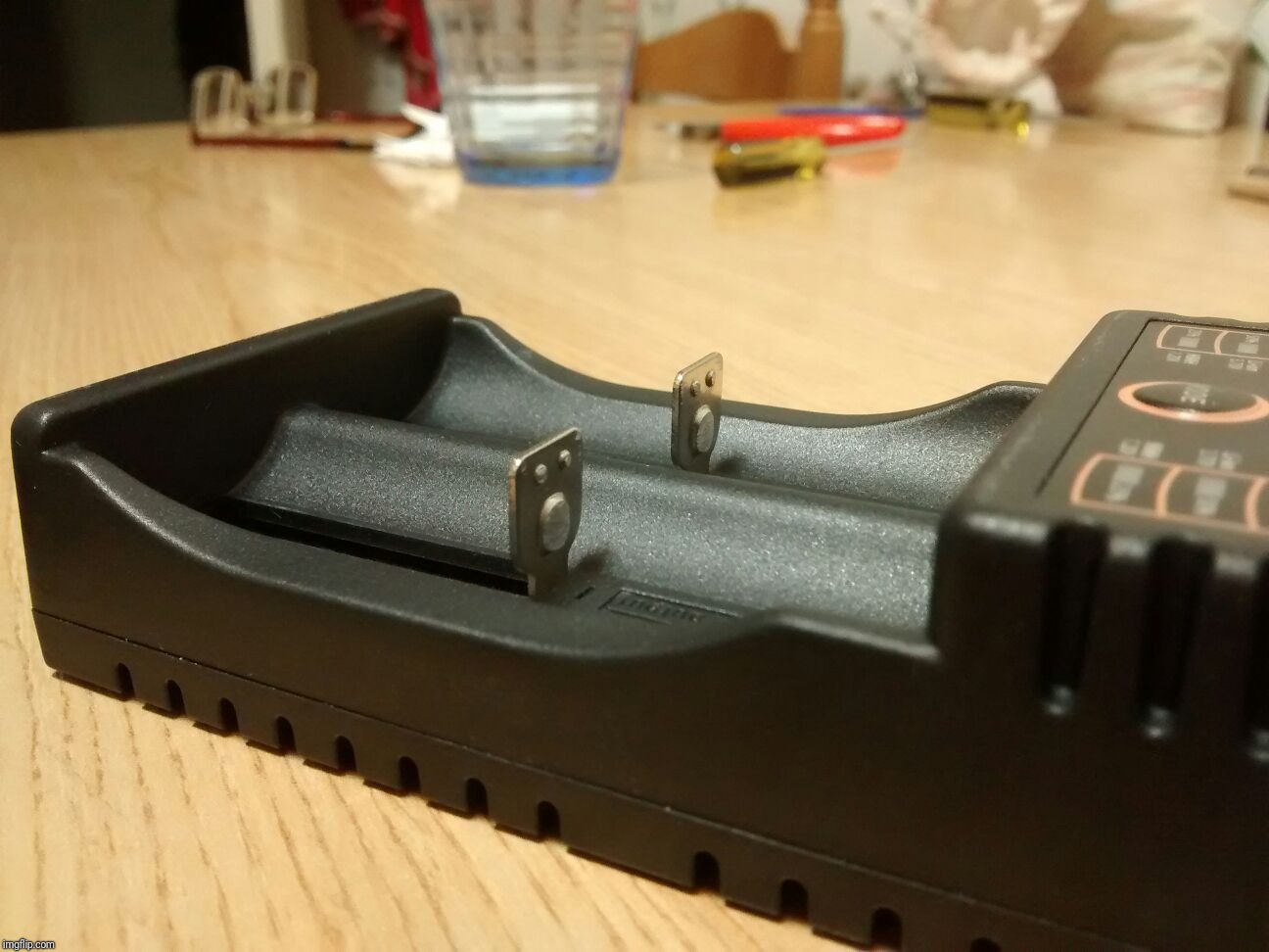

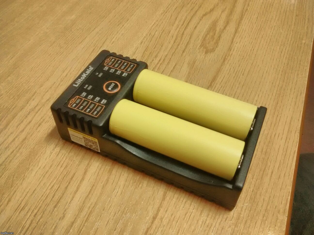

lii-500 with lii-40A 21700 70.4 mm long - can be loaded but it is very tight, so strained until it causes small dents in the cell, I do not recommend
lii-500 with sofirn 21700 4000mAh 70.7mm length - you do not put in the charger, it is too long

LiitoKala Lii-40A cells (Lishen LS21700-SA).
