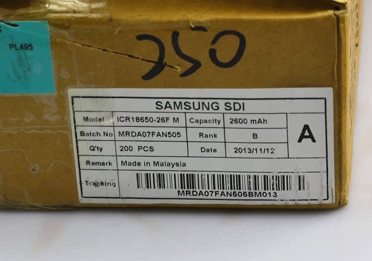

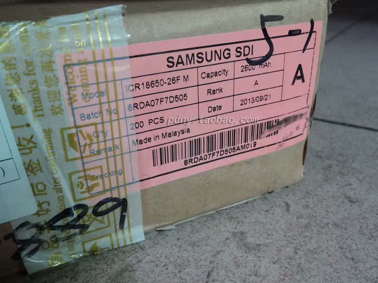

What does M and SDIEM mean?
What I didn't know before,there are different ranks for samsung cells.For example:
What's the difference between rank A and B and how to know which rank we get?

I’m not sure, but my guess that’s stand for Samsung SDI Energy Malaysia (SDIEM).

Yup, it refers to the Malaysian division of Samsung SDI. There is no indication of the "Rank" correlating to battery quality.
