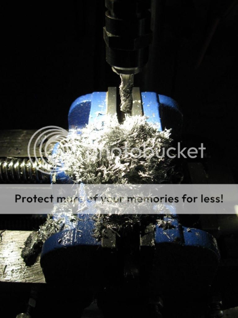

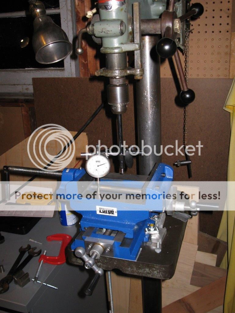

nice work, especially on using an endmill holder (MT3 taper? how's it held in?) instead of the chuck. I did much the same to my drill press, using one of those crappy but now heavily modified HF X-Y vises:
It does surprisingly decent work, within pretty major limitations. Still, it allows me to do a lot of things I couldn't otherwise do, so that's what matters. Wish mine had a rack and hand crank for the table as it's bloody heavy. I need to rig up some kind of hydraulic jack underneath to help out.

Nice job comfy… You can attach a digital caliper to the vise too- I’ve done before it and it works… Milled aluminum down to a 10th of an inch accurate. It’s a lot easier than checking your work. There’s a lot of ways to make a ghetto mill for around 400 bucks. Harbor even sells a cross vise but shimming that sucker will take a day or so lol
