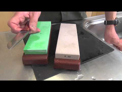

One of the last remaining arts is knowing how to sharpen knifes with wet stones.
virtuovice on YouTube is a good teacher.
(Sharpening begins at 09:00 minute mark)
