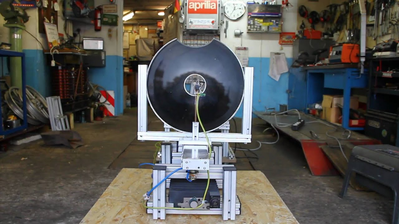

Some fun with bike lights!
There is a XM-L bike light here as comparison. The XM-L nearly vanished. hehe

Another nice video!

As an optician I cry a little when I see the torture that lens goes through. And I’ve lit trees on fire a lot quicker than that cardboard. To put it into perspective… Think about harnessing the power of the sun across 48 inches and focusing it down to a point approximatly .25”… it litterally says POOF and flames erupt!
