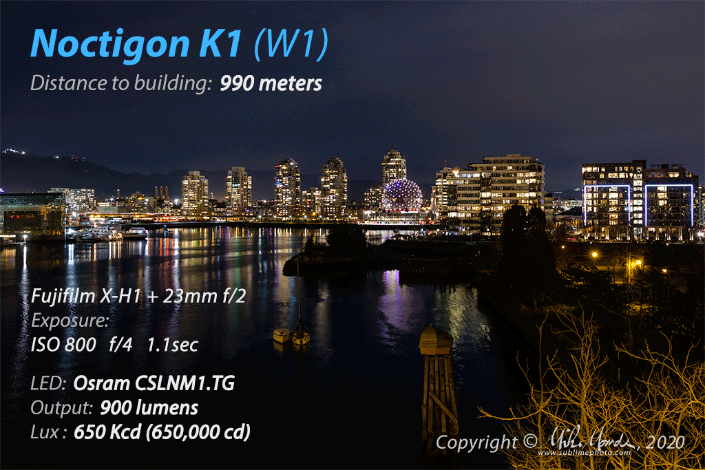

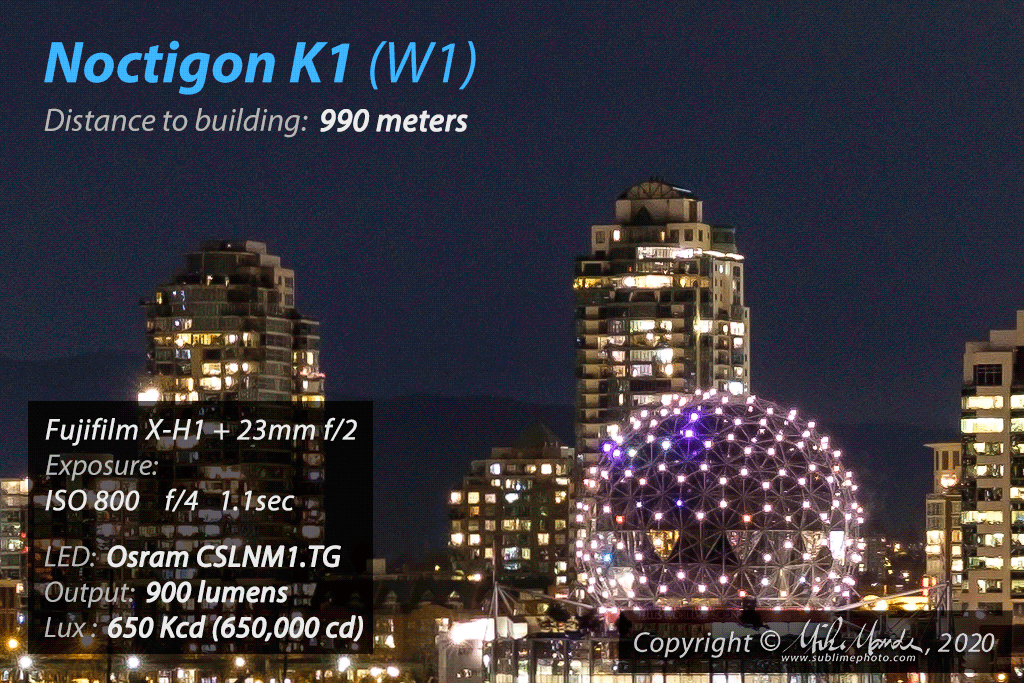

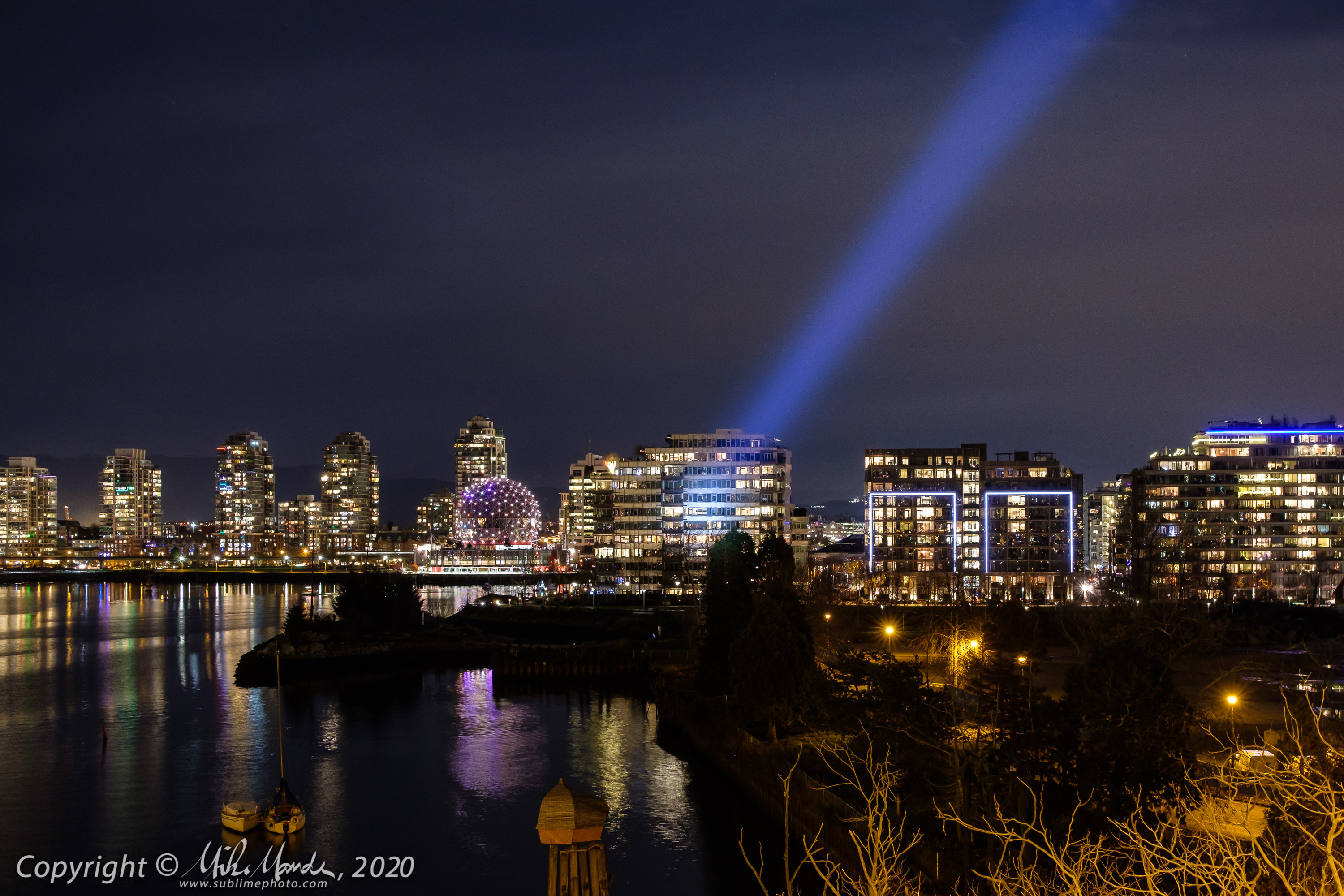

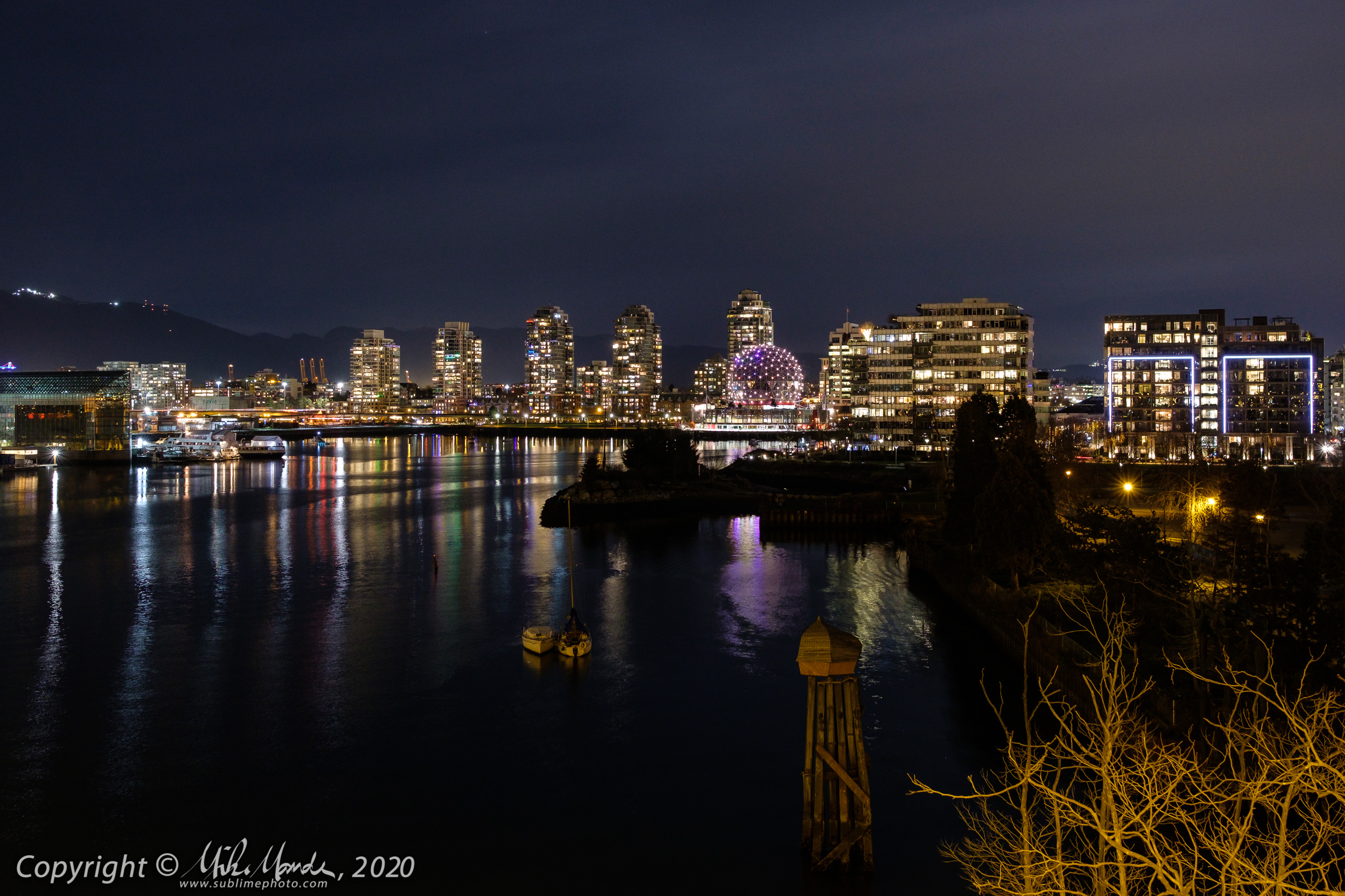

I received my Noctigon K1 (W1) yesterday. I was initially a little disappointed with the output, but 900 lumens is 900 lumens, no matter how tightly focused, and is a whole lot less than, for example, my D4v2 or D4S. But shine it at a distance and man… what a tightly focused beam! The only other throwers I own are an old ThruNite TN32, a ThruNite Catapult V6, and a CPF Italia Cometa. I once also had an Olight SR52UT, but I sold it some time ago. Anyway, this K1 just destroys all of those of course.
I walked home from work today and took a few impromptu beamshots. I didn’t have a tripod, which made it a bit difficult. There was also a near full-moon and a bit of overcast haze. Following are two animated GIFs showing the same set of images, the first the full image, and the second zoomed in at the pixel level of my 24MP camera. The camera was precariously balanced on a bridge railing (Cambie Street bridge in Vancouver, Canada) and I handheld the light, which might have wavered around a bit during the just over 1-second exposure. The beam spot size on the building and intensity might have been better had the light also been locked down. These shots are fairly representative of what I saw with my reasonably dark adapted eyes, although a wee bit brighter than real life I’d reckon.
In any case, the K1 has no problem visually hitting the side of a building that is near 1 km away on a moonlit night in the city! :sunglasses:

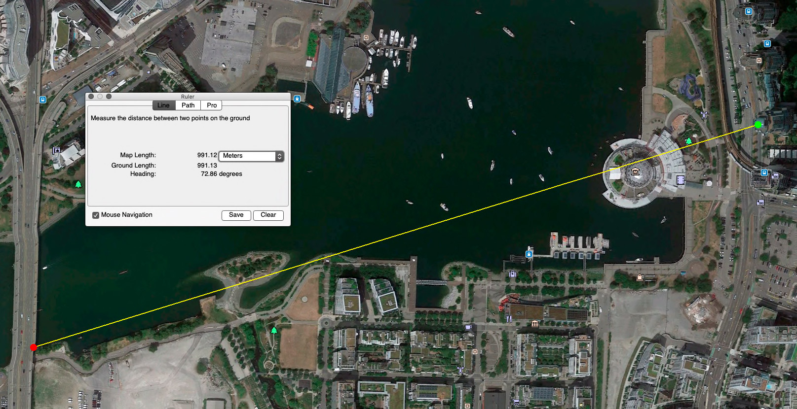

Here is a Google Earth measurement, the red dot on the left is where I was on the bridge and the green dot on the right is the target…
Here are links to larger JPEG versions of each image, the control and the beamshot.
Lastly a few more points… I should add that my Samsung 40T battery was at 4.0v (as reported by the light) and the temperature outside was about 4 Celsius. Also, the numbers shown on the animations are the manufacturer’s specifications since I have no way of measuring them myself. When I received my K1, the beam focus looked a tiny bit off. The SS bezel was not fully tightened, so I smacked the end of the light in my palm a few times and sure enough, I managed to improve the beam focus, after which I tightened the bezel down. I suspect the focus was probably good from the factory, but during shipment it might have shifted a little?

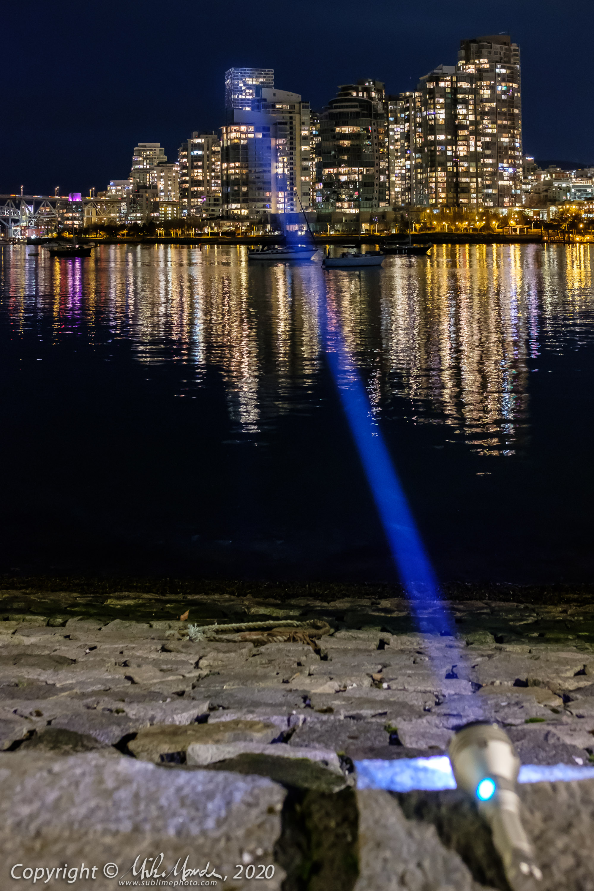

Here are two more beamshots from tonight, but no fancy animations this time. They take too long to do and it’s getting late. You can click on each image to open larger versions, 3000 pixels on the long edge.
This one is also from the Cambie Street Bridge, and in this case the building I am hitting is about 410 meters away, according to Google Earth. The beam sure is bright on that building…
This one is from False Creek, hitting the 160 meter high top of the weird new twisted apartment building. This is 950 meters away according to Google Earth and the exposure is different than the previous ones: handheld (not propped) at ISO 3200, f/3.6 and 1/4 second…

If there was a prize for best K1 beam shot, I think you just won it. I haven’t seen any other photos which so clearly demonstrate what this light does… and it’s also generally just a great picture.
