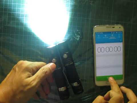

Ramping time appears to have improved in the new batch of SP32A (ordered during the special sale last end of March 2018 and arrived a few days ago; the “handled by AliExpress” ships really fast…).
(whereas in the original older batch, from Low-to-High or vice-versa, it takes about 7 seconds; in the new batch, the ramping takes around 3.5-4 seconds; there is still a very slight pause somewhere in the middle of the ramping — I’m not sure what’s the pause for…)
(testing ramping speed on new & old SP32A; new on the left, old on the right)
(sorry the stopwatch is not exactly the time, since I don’t have 3 hands to simultaneously start the testing…)
(ramping on the old batch SP32A ~ 7 seconds)
(ramping on the new batch SP32A ~ 3.5 seconds)
