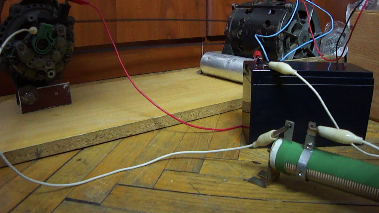

Here you go they removed his other videos. He uses a car battery to get a big DC motor spinning. Once the alternator is up to rpm you can remove the car battery the alternator is making way more then enough power to spin it. It can’t power it until you get it spinning and the alternator is making current. Imma try to dig on another video site he shows it and it makes 90 amps. YouTube removed that one. This video shows the concept. But I’ll try to find it in action

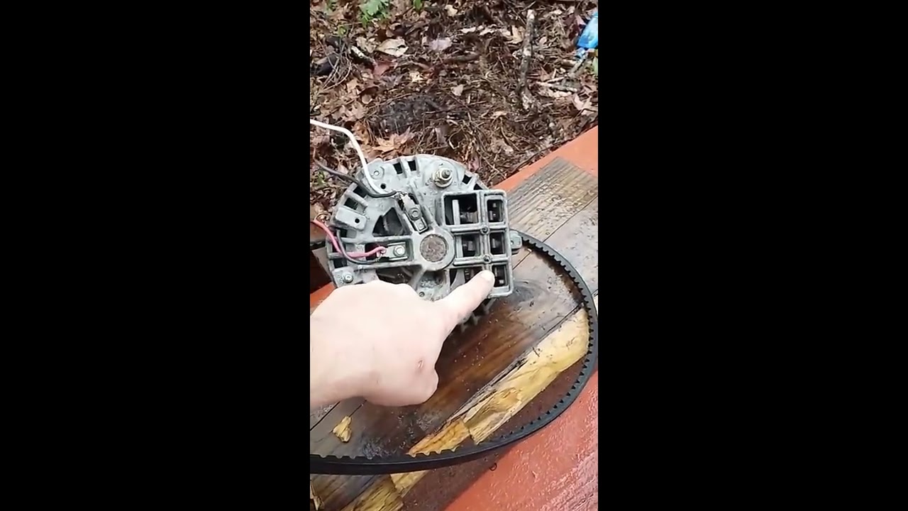

This one shows more of what I’m talking about. It’s not a long video. You can get 120v or 220v from a alternator and make it DC or ac. Whether you want to make a portable welder or portable generator.
I kick myself for not downloading thaf other video. He showed how to set it up more then this guy and showed it powering real appliances not just light bulbs. He had it ran to some kind of box thingy. IDK know all about electronics like this people do can’t remember it’s name. And somehow my father in law turn his alternator into a generator for their house. Me and my wife didn’t know each other then. I never got to ask him. Maybe his son will know how he did it. It wasn’t a power inverter, he didn’t something and ran wires. But he was German and very smart I’ll keep digging need to go off YouTube to probably find the good stuff. That first video is poo poo to the first one that was up for months. YouTube told him he can’t show it in its completed form. No step by step or anything. He played the threatening voice mails he had. It really tickled some people. Which any voice mail can be suspicious but a lot of his videos disappeared after that. The really good ones. It took work and wires and doodads I think converters, I really don’t know hooked up. but imma try my damnest to find that video . But it worked running realmultiple appliances at once. But the base of all these is a DC motor and alternator once it gets going it’s going you could leave the battery on but with some set ups you don’t have to. You can run 12volt back to it once power is up and not need the battery anymore. Just like your vehicle you need it to get started.but once it’s started you can pull your battery out alternator powers everything. Instead of a engine, which needs gas you have a DC motor and it can feed itself. But you’ll always need a battery or a wall plug to get it started.

I can’t believe I actually watched the whole thing, there is nothing there. He doesn’t even understand that 90 amps at 12v is not the same as 90 amps at 220v.
You cannot get more power out of an alternator than you put in, it really is that simple. The mechanical power to drive it will always be more than the electrical power generated.If you use a 100W motor to turn your alternator, as soon as you try to draw more than maybe 70W out of it everything will grind to a halt.
