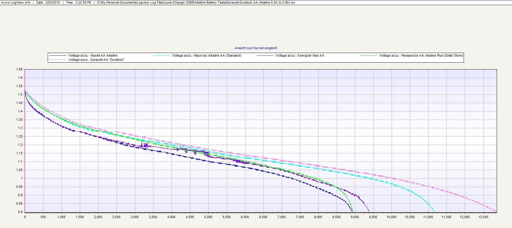

WOW! Just blew the rest out of the water! Duracell "with Duralock" = 1,799mAh! 3hrs 34mins runtime (Energizer was 2hrs 36mins). Duracell has higher voltage than both Panasonic and Energizer. Graph comparison:
(Sorry if the above image is not appearing, I'm out of Photobucket bandwidth and it will reset on the 24th of the month (I believe).)

After the Duracell rested awhile (about 15 to 20 minutes) it was back up to 1.27v (which every cell I have tested thus far has sprung back to) so I tried to begin another 0.5A discharge. I got another 109mAh out of it. I did NOT do this with any of the other cells.

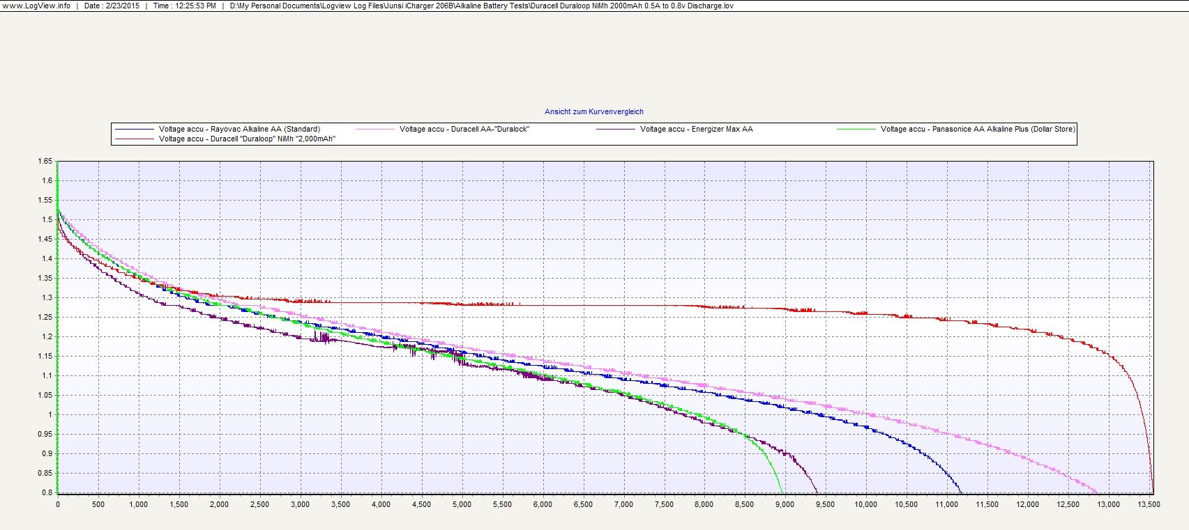

I just finished a test on a "standard" Rayovac alkaline (standard silver & blue with the "Lasts as Long as Duracell" labeling on the package) = 1,564 mAh. Performance is close to the Duracell with slightly less capacity (perhaps the claim is based on a lower current draw). I also tested a Duracell 2,000mAh NiMh "Duraloop" for comparison. It is clearly seen how the NiMh cell holds voltage much better and has more capacity than even the Duracell alkaline. (Note my tested capacity came very close to HKJ's Eneloop test, so I feel pretty confident with my tests.) Graph:
EDIT - here is a direct link to the above picture that works.

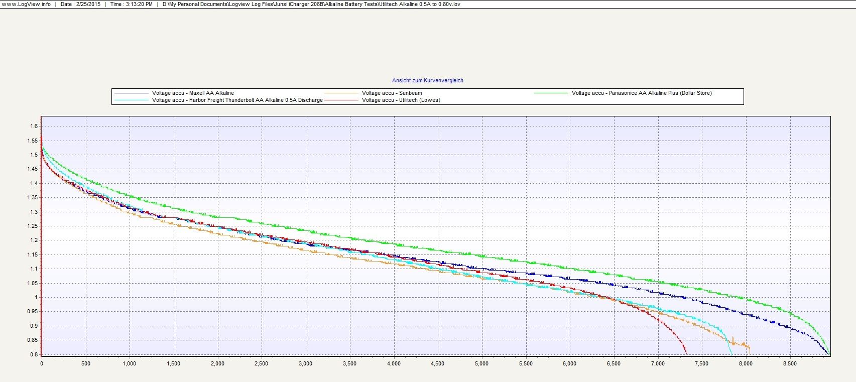

Received my Maxell's from Amazon ($13.97 for pack of 48) today and put one right on the discharger. Total capacity = 1,251mAh, for 2 hours 28 minutes of run time. Here is a graph comparing to the other similar performing cells:
Graph comparing to the better performing cells:

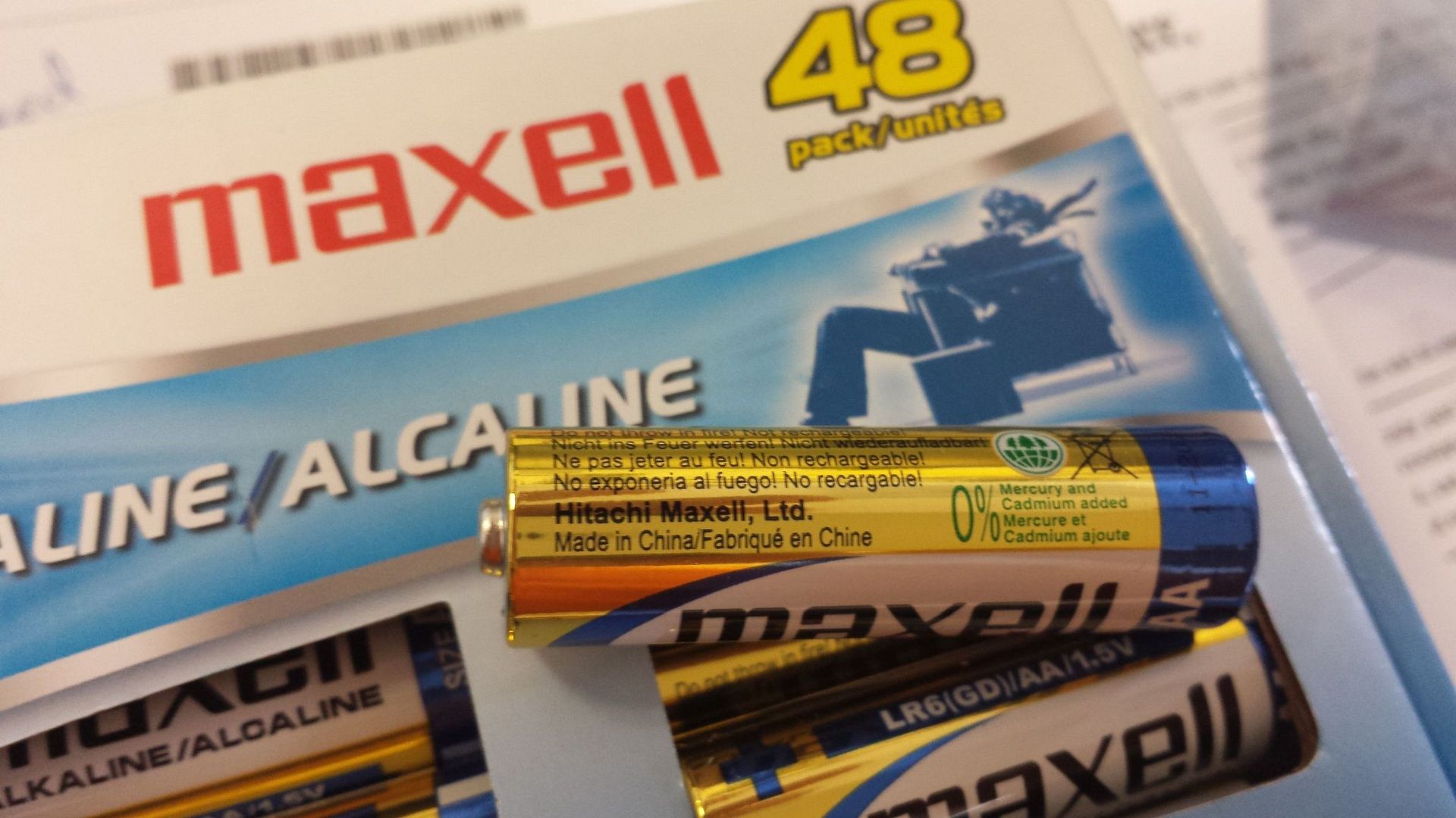

Photos of the Maxell's (they are made in China):
So far it might be the best performer for the price depending on how cheap you can buy the Panasonics. I'm still interested in the Amazon Basics.

I am in the slow group, but I cannot read the graphs. What do I need to do?

What do you mean? You don't understand the graph? Or you can't see them?
-Garry
Done :slight_smile:
The graphs are so small I can’t read them.
Jerry
How about going directly to my PhotoBucket gallery and viewing them there (you can enlarge them there too)?
-Garry
Thanks, that is better.
