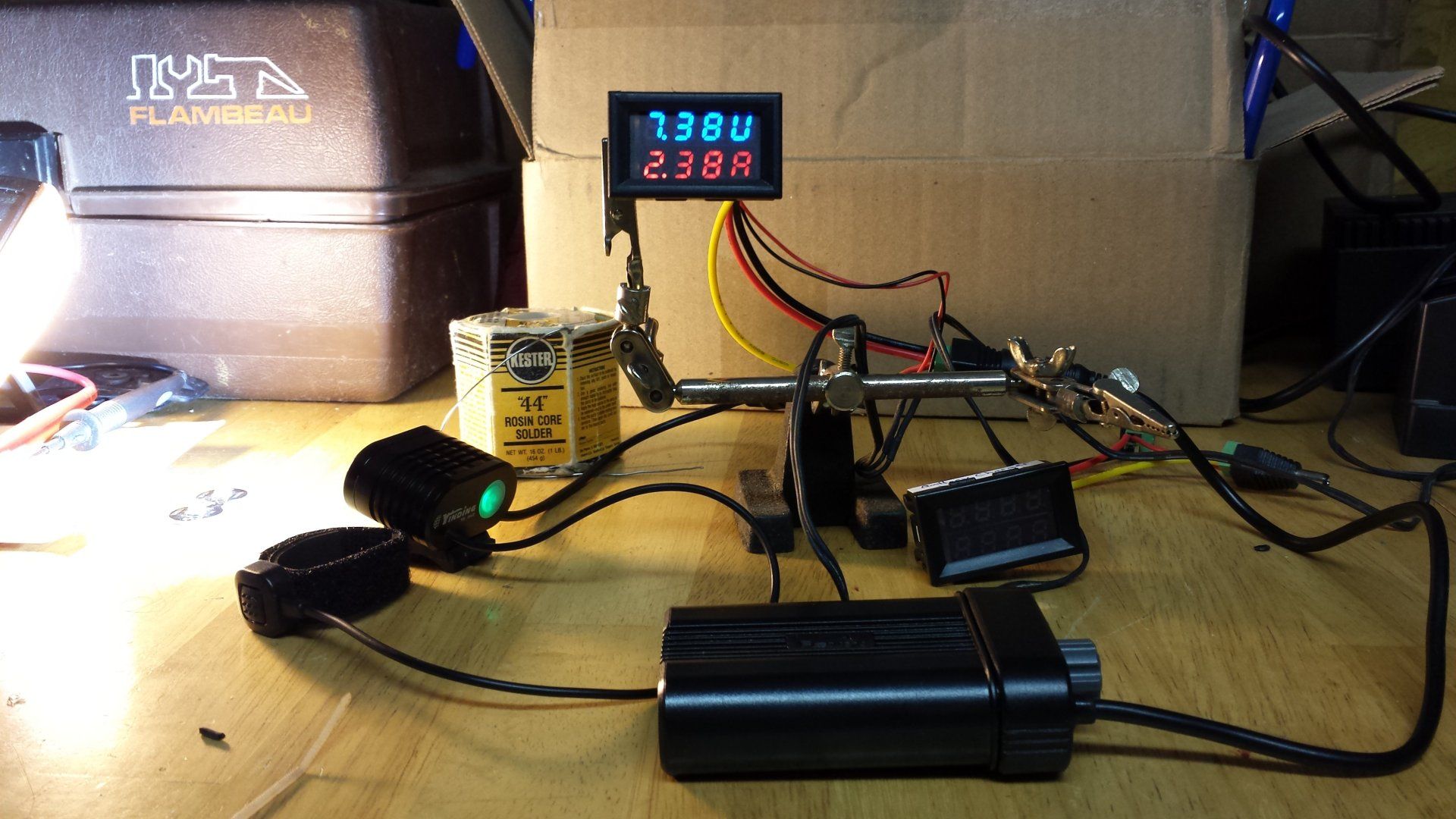

And testing it out after a full charge (which takes a LOOONNGG time on a wall wart "1A" charger!) on my BT40S modded to a calculated 4A:
This is the highest current measurement yet on this light! Voltage is even high enough to keep the lights battery level indicator blue instead of red.

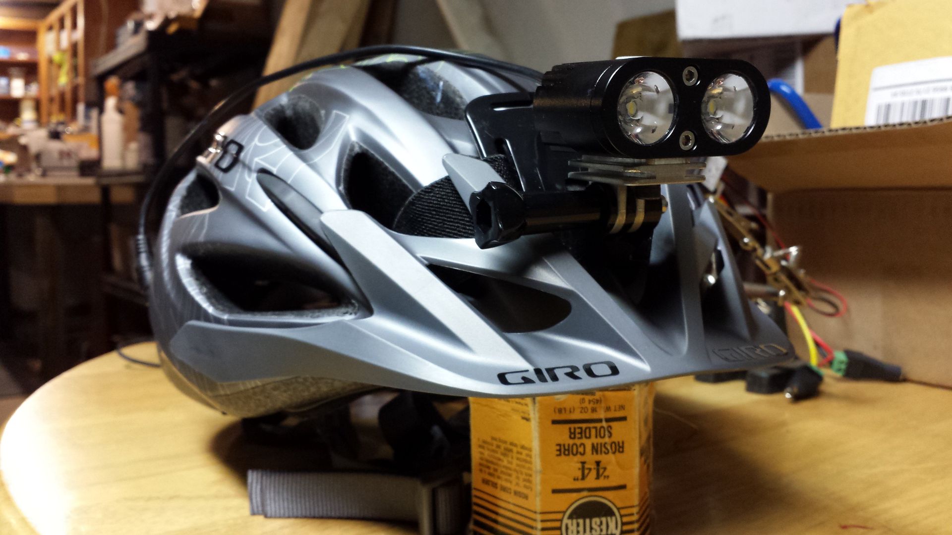

I don't have a pic mounted to a helmet (need an aluminum GoPro adapter with additional heatsinking yet) but here is one I stole from user tigris99 (hope he doesn't mind). (Note the remote switch mounted to the side of the helmet too):
Mine will be mounted lower in the front like my BT21 shown here:

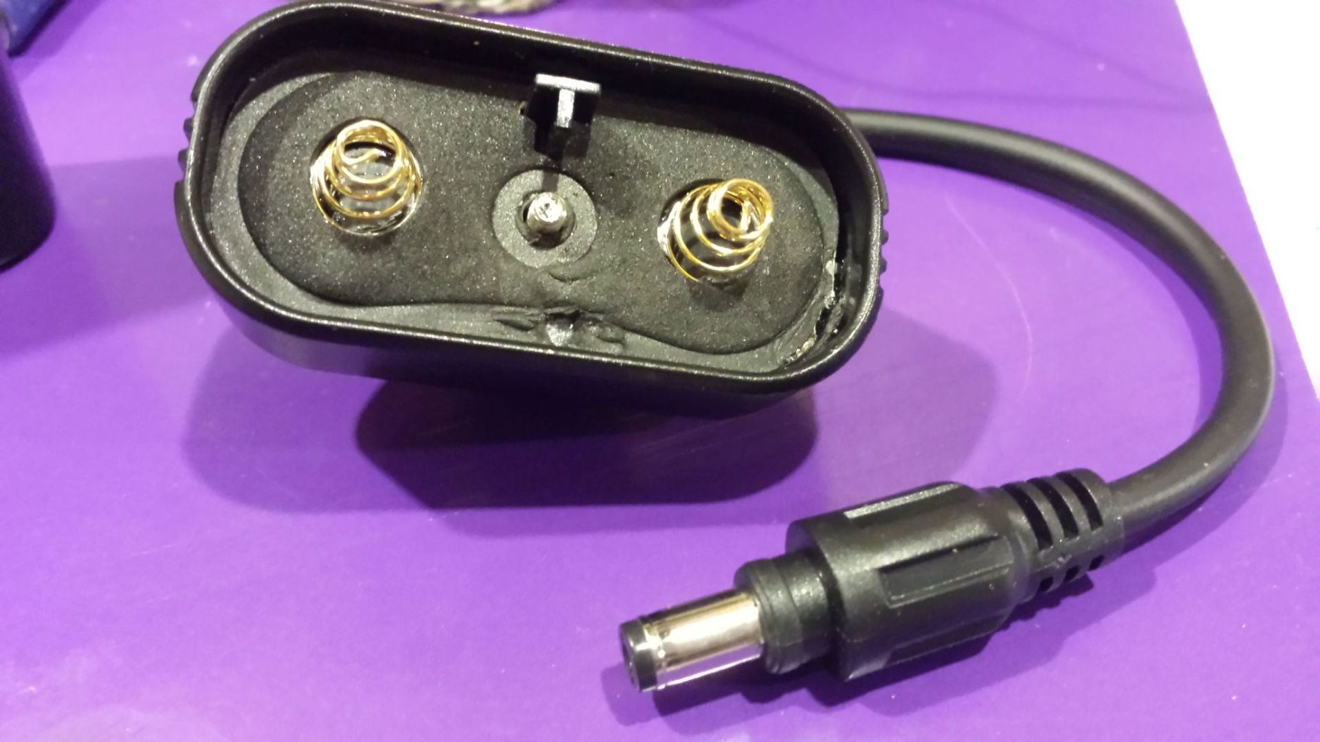

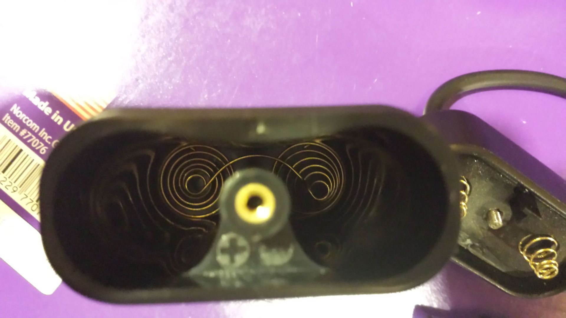

Did a little mod to my 2-cell Fenix Bike Battery Case replacing the top springs with buttons from Mountain Electronics. I have already replaced the stock Fenix cable with the 20ga DX one (the stock Fenix cable has the opposite connector on it anyway). The buttons are too small to reach the pcb contacts (perhaps I could have just scraped away at the pcb), so I used pieces of copper under each button. Fairly easy to do and the bottom springs still provide plenty of tension on the battery (it was quite a bit of tension with both sets of springs).
Pics:
With two protected Sanyo 2,600mAh FM's:
BTW - these cases are no longer available.
A few more pics showing the other side of the pcb since I didn't post anything on the cable mod:
One two nearly full charged protected 2,600 Sanyo cells in a modded Fenix 2-cell case:
Tried two mismatched mostly charged up high-discharge cells and saw slightly higher current:

How do you like the Go Pro adapter with the additional heatsinking? Do you think it would transmit too much vibration mounted on a handlebar? Looks so cool on the silver helmet.
I don't know that the vibration is really any worse than using the standard o-ring mounts. I've yet to ride using the GoPro mount though. Work schedule screwed me out of riding last week and this week's ride was cancelled due to rain (local club rides on Tuesday nights). Not sure how much longer I'll have to be able to ride before snow hits (and stays around for the next 4 months).
Pics:
Stock:
Bottom Springs:
-Garry
