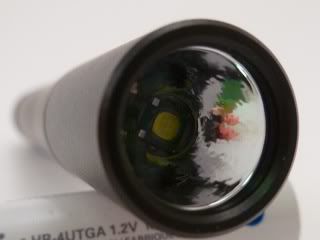

The RA02 features a Cree XP-G R5 emitter. The XP-G is currently the go-to choice for giving a light good throw from a small reflector. The R5 flux bin (brightness group) is the third brightest available for an XP-G, topped only by S2 and S3. This XP-G sits inside a small reflector with LOP (light orange peel) texture, which serves to smooth out any imperfections in the beam at the cost of a little throwing distance.
The emitter and reflector sit behind a small lens and O-ring, held against a solid head with no bezel.
