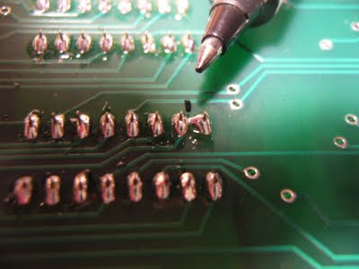

I shorted the resistor by removing it and connecting the two pads with a solder blob. Smile
I think it’s called a solder bridge:
