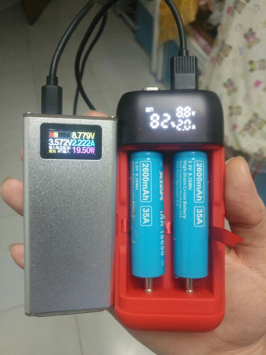

The YZX Studio Terminator T12B is an advanced 2x 21700 powerbank, but I'm not sure if the batteries are easily removable, and this item would likely be difficult to source outside of China..
Item link (Taobao - China - website is in Chinese)
https://item.taobao.com/item.htm?spm=a1z10.5-c.w4002-5539902433.14.78291...
(not sure but the 2x21700 batteries may be built-in, and not easily removable though)..
Some other pictures from user feedback in Taobao:
