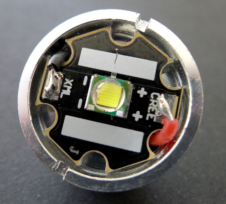

Best I can show you is this
See the star, if it’s not physically attached to the pill the heat can’t transfer efficiently
Aluminum stars have a dielectric (PCB) under the emitter…think of it as a thermal insulator between emitter and the aluminum…heat does get thru but alot slower
Copper star the emitter is soldered directly to the star (the PCB has been cut away exposing raw metal underneath, copper can be soldered to…aluminum is much much harder to solder to)
By putting a thin bead of JB Weld under the star on that metal lip bonds the star to the pill allowing better heat flow…on the back side of the star there is a mm or two of empty space…by putting in a blob of JB Weld and letting it flatten to that lip it increases the surface area allowing more heat to flow…JB Weld isn’t the best heat conductive material but it’s better than having just air there, you don’t fill up the entire space…just the rim of the ledge on the back side of the star
Artic Alumina is supposedly superior thermally conductive epoxy vs JB Weld…but JB Weld is cheaper
Just remember epoxy for the most part is PERMANENT…you can break it free but usually requires alot of force or heat
This is an unfixed just laying in there hollow pill with star…there usually is a small plastic ring pressing the star to the pill…not very effective
This is a solid pill (notice it has full metal on the back where the star bonds to [this is the back side where the driver goes]) (by Relic)
