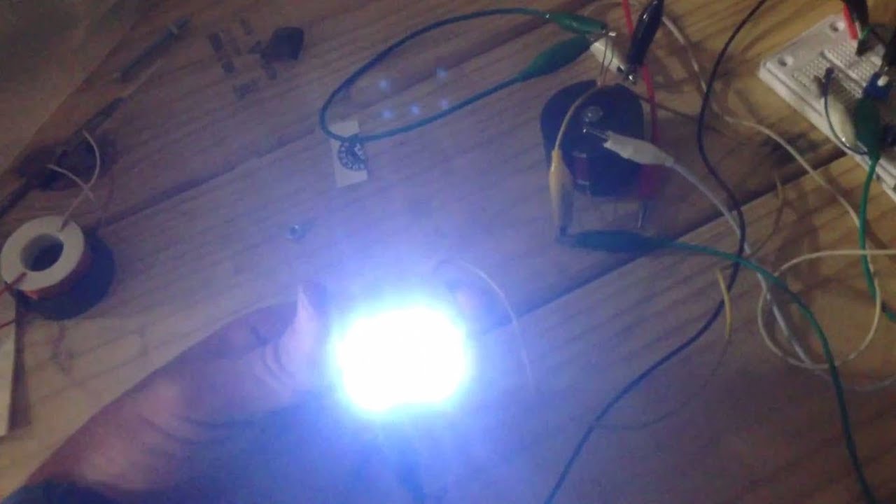

Yes it operates similar to a shake light and a joule thief, but this guys circuit loops back the pulses and can run for HOURS vs minutes charging those small button ultra capacitors
I wonder if it is capable of pushing a few hundred mA continuous…imagine pushing a XP-E/G instead of those teeny 5mm LED’s
In fact check out his youtube channel…the guy has a TON of great experiments

It’s a big cap, but it still doesn’t store much energy. He doesn’t mention in his video how many mA he’s feeding that 10mm LED, but I’d say it’s on the low side. Seems like it will light up down to maybe 2-3mA, so that’s probably where the drive current is hovering = from 5mA after a fresh shake down to 2-3mA for a long time.
If that’s the case, I’d say he’s getting maybe 0.02 to 0.1 lumens based on a lot of back-of-the-napkin math.

What I meant to mention in there is that with the small amount of energy he’s got on tap, driving an XP-G is probably out of the question. I’m not into the joule thief scene - can you run an XP- series LED off of a joule thief?
True…watch his other video’s he runs incandescent with em…and it appears from the schematic side (the 100 turns), with fewer turns and thicker wire he might be able to lower the voltage (he runs 9 led’s in series) imagine dropping the volts to 3~ but upping the current by 9x…
The cool thing is…it runs for a very long time from a single bump of a charge, whether it be a magnet or from a bump charge from a battery
It’s not a joule thief it runs on it’s own feedback, thus the joule ringer
