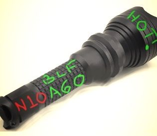

53x51mm reflector, single 18650 battery. No pill, built into the head just like the A60. Looks similar to the A60. Should be better made. 57mm head, 178mm length. Type III anodizing. Only issue is price. It’s costing me like $30.50 each shipped for 5 hosts. Actual price is $25 plus shipping. I had to order 5 so the shipping and paypal fees didn’t rape me. If we were to order 50, the price would go down to $23 each, but if we did this as a group you have to add shipping costs to company, shipping to us, paypal fees, and profit so we would be back at $30-35 shipped for a group buy if I had to take a guess. I will just have to see. I just paid so I will let you know how they turn out.

Might be interested, a little pricey for a host of that size (last I paid for a A60 was like $11-$12), but if it came with a decent AR lens on top of the quality advantages, then maybe. Id' be interested though to see what de-domed LED performs best in it without modding the reflector.
For my de-domed XP-E2 R3 1D0 Jacob, the best I can get is 165 kcd after finding the right amps (~2.4A - 2.6A), perfectly focused, and with a UCL lens. I'm testing at 5 meters, so not sure if a longer test distance would produce higher #'s. I might have a bad (lower performing) LED or bad hot de-dome, though it all looks very good.

So when we speak about N10A60 with 57mm head, 178mm length it will be bit larger in size and bit heavier. Jacob has plastic reflector and because of that it has thin wall diameter while N10A60 has aluminum and it should he thicker wall which means it could have less than 50mm usable diameter but with bigger depth.
So yes N10A60 could become new champ... I see potential...

I wonder what kind of thrower this would be. 159mm*63mm*63mm
http://szobm.en.alibaba.com/product/60152730337-200275902/Wholesale_OEM_LED_Flashlight_Torch_for_tracking_XM_L2_LED_1200_lumen_powerful_Fast_Track_Flashlight.html
Funny you mentioned that. I’ve already contacted them. I’m waiting to hear back what the reflector measurements are. Doesn’t matter if it is a 60mm reflector if it is only 30mm deep.
Looks like a HD2010 head on a 18650 tube... ? HD2010 reflectors are fairly shallow, but throw a ton. In this case, depth is not as important as width Smile.
