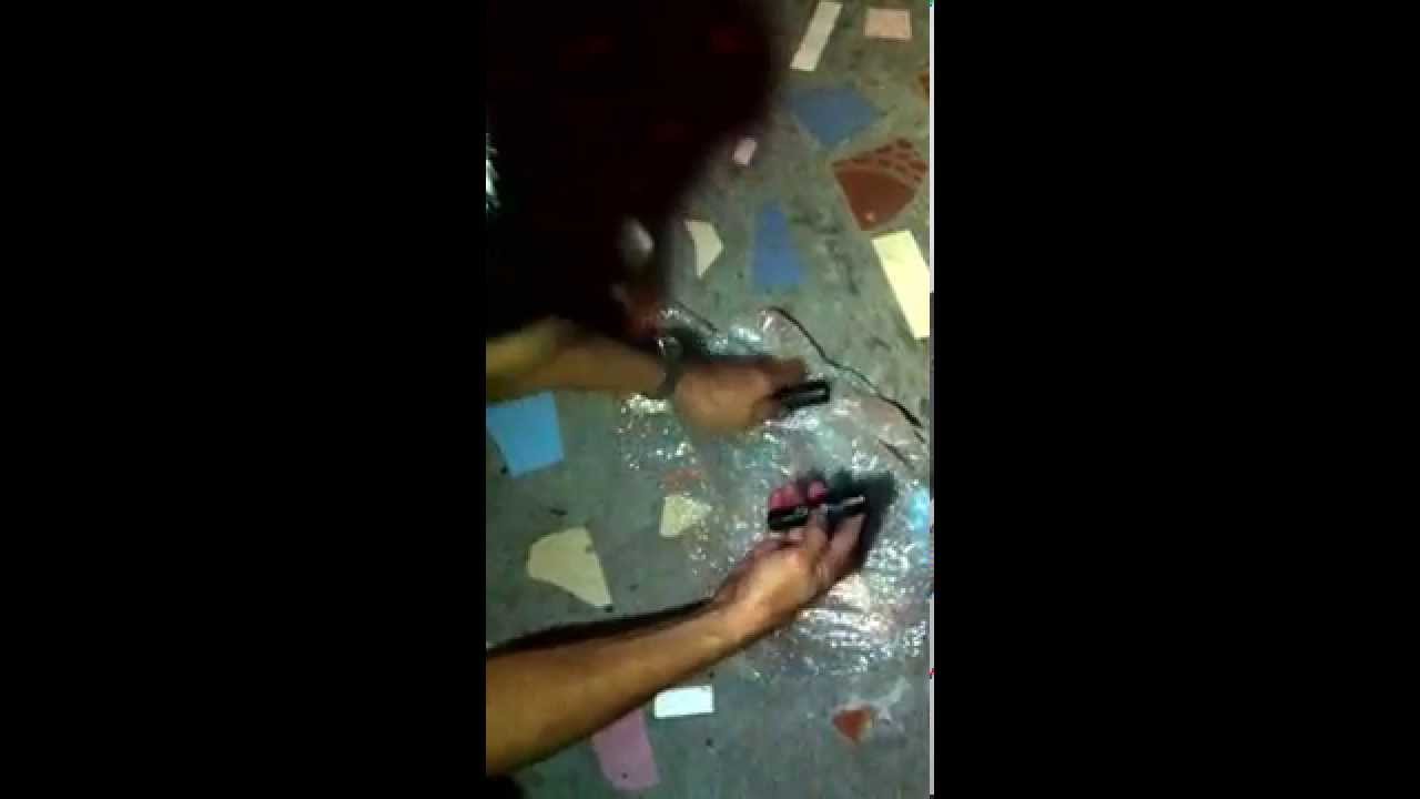

My cellphone’s video rendition below, while does not show high accuracy as compared to the still photos above, nevertheless shows the highly-vaunted IMR versus the Sanyo.
Click on the YouTube logo on the bottom right to watch via Youtube for maximized video.

I just added a short video clip, taken from another pair of EA11s, but still using the Sanyo and Nitecore IMR 14500 in the op.
