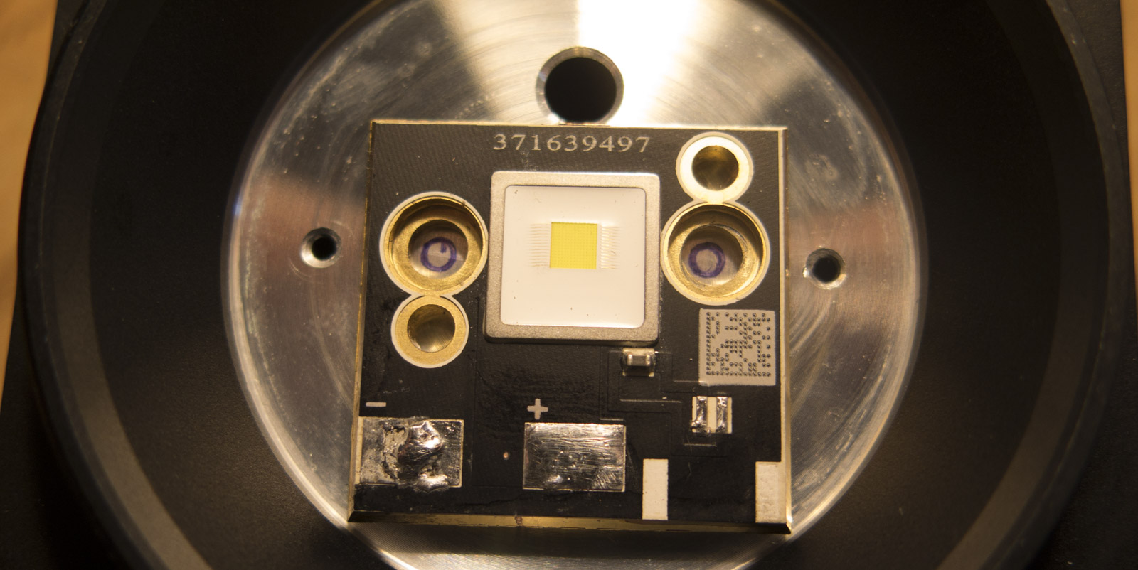

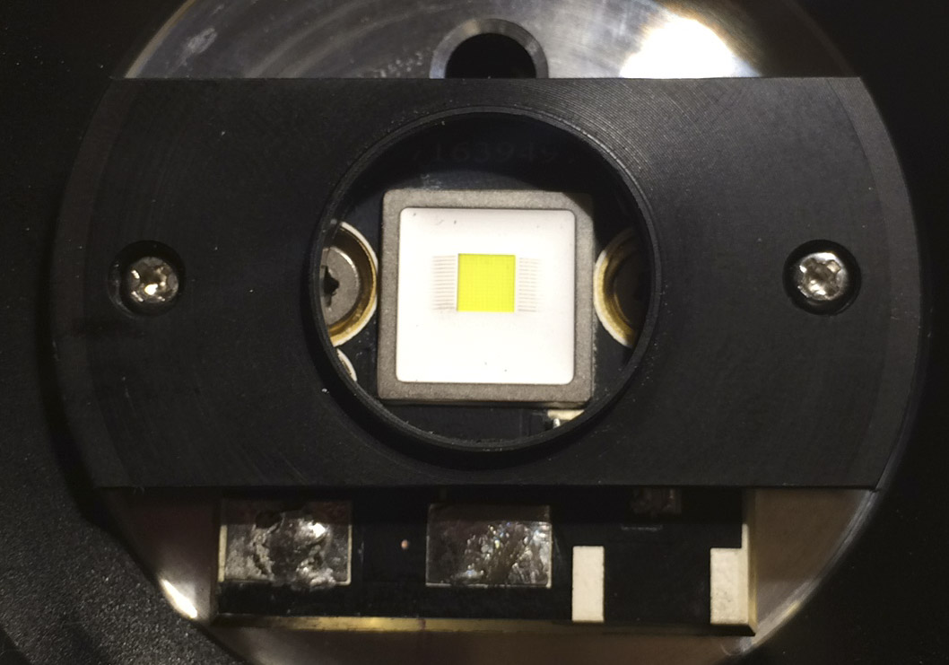

LED mounting the GT is easier than in the Tn42 as I can open the head close to the LED

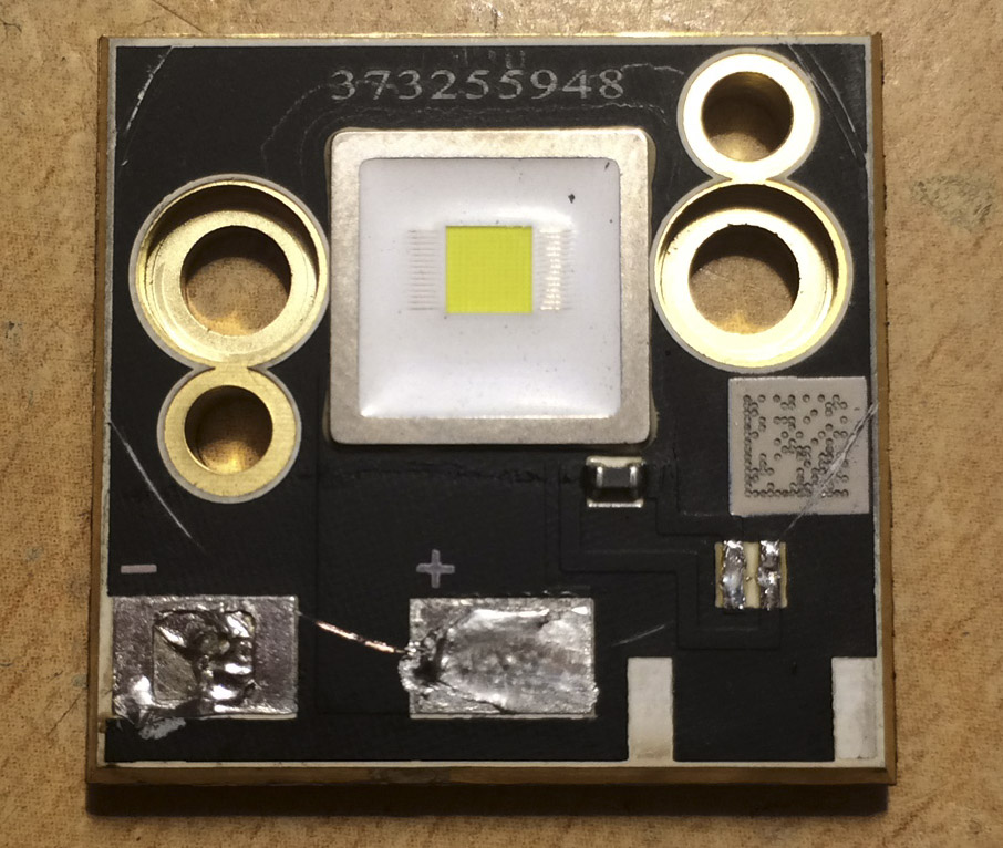

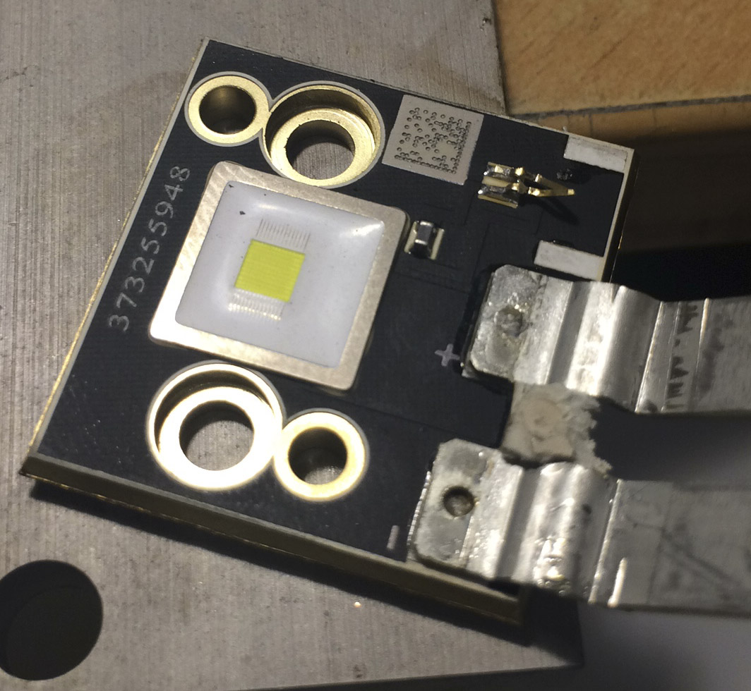

first get those connectors off them, not easy as the LED- is as well the copper core
So I decided to destroy the plastic part and use a 30000°C gas burner to get it desoldered which worked
Unsoldered
Integrating in the GT
marks for drilling holes and make M2.5 threads
M2.5 screws fit nice, my M3 are too high
Also drilled two 6mm holes for wires

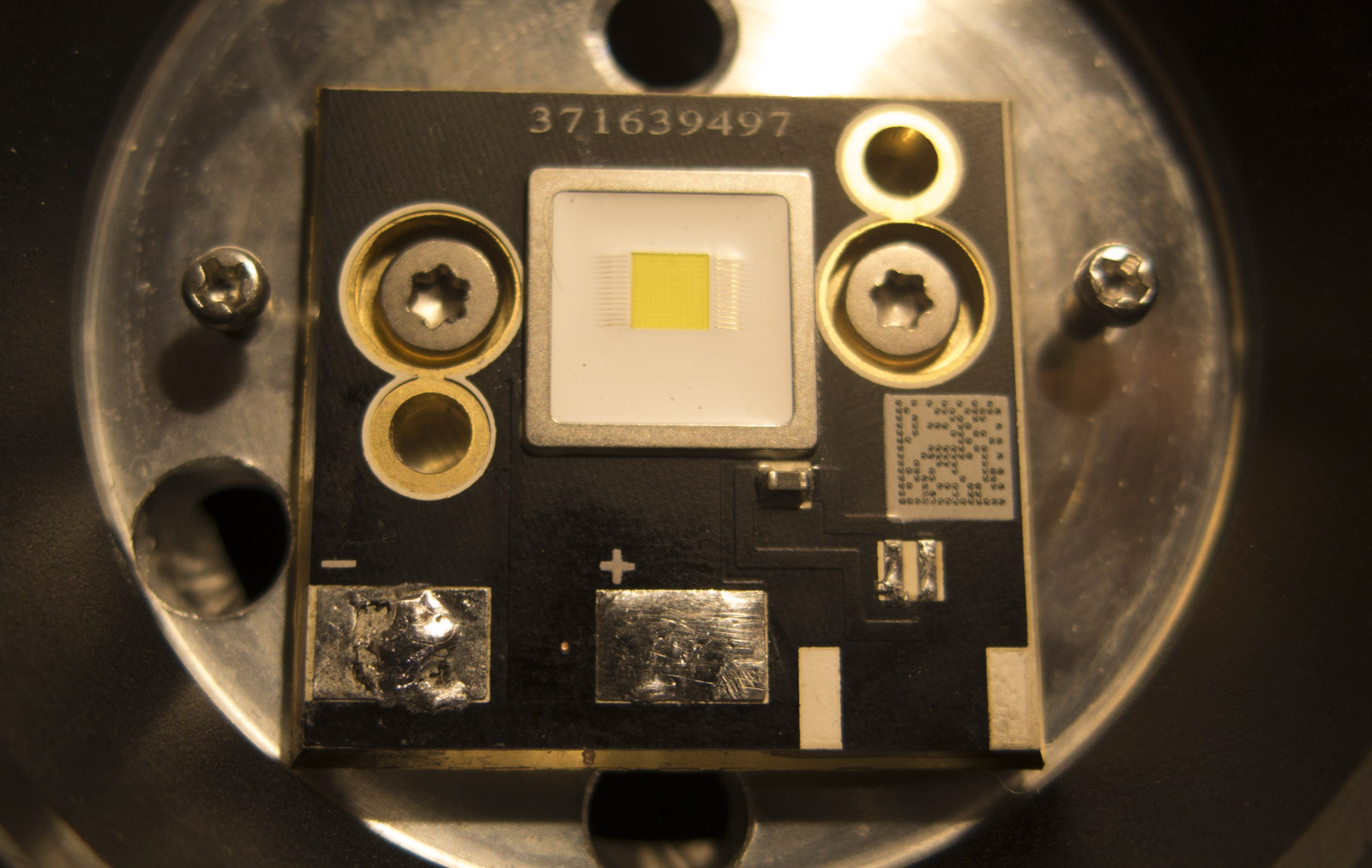

The centering bar in palce it was sanded about 0.7mm to get the LED in the focal plane
I need to glue later the scres from it as they are not fixed
soldered two times 2x1.5mm² silicone wire, squeezed it flat and insulated with kapton tape, even if it is not as high as the centering bar
The centering bar needed to be trimmed a bit
head parts screwed to one piece
I put the LED on a 5A bench PSU for a quick beam shot, the focal point might not be ideal
This is the 6500K variant vs 4000K GT XHP35

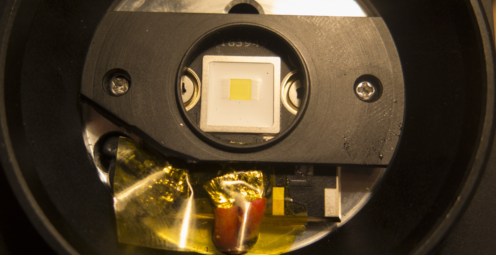

Now to the TN42

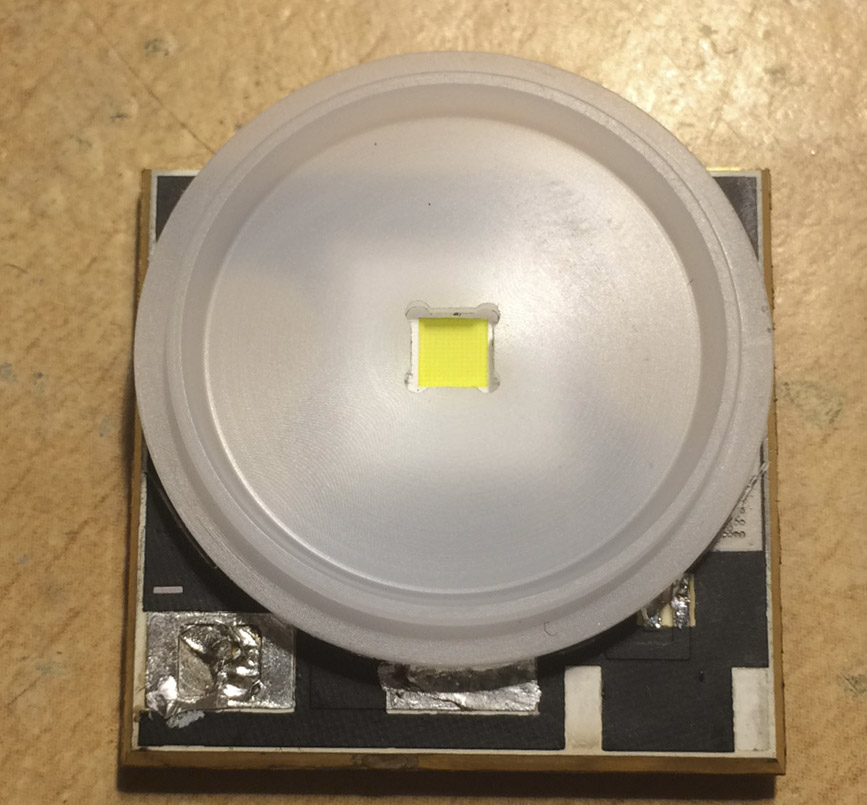

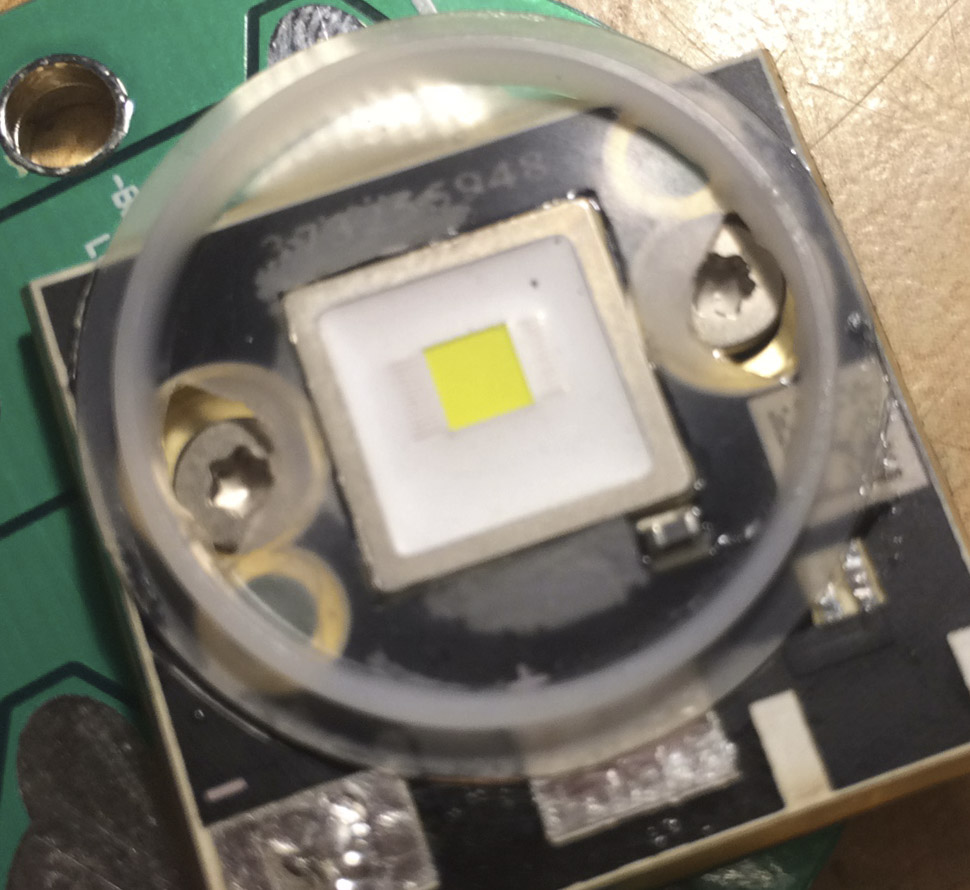

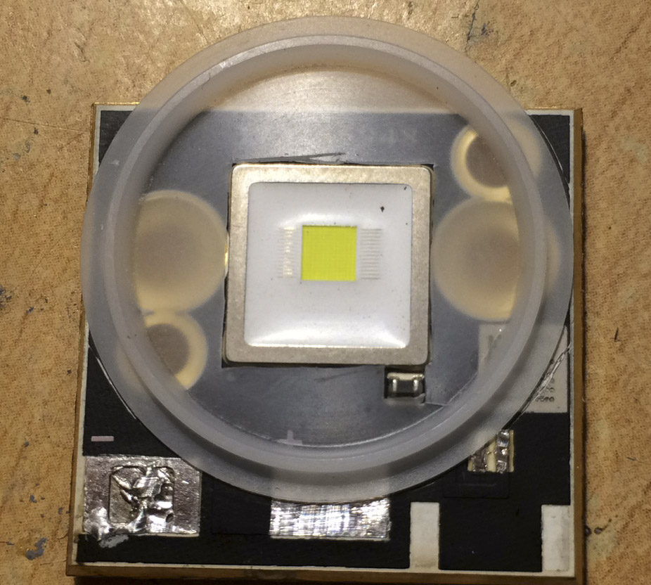

Putting the centering piece on the LED
now marked its outer diameter on the LED board with a knive

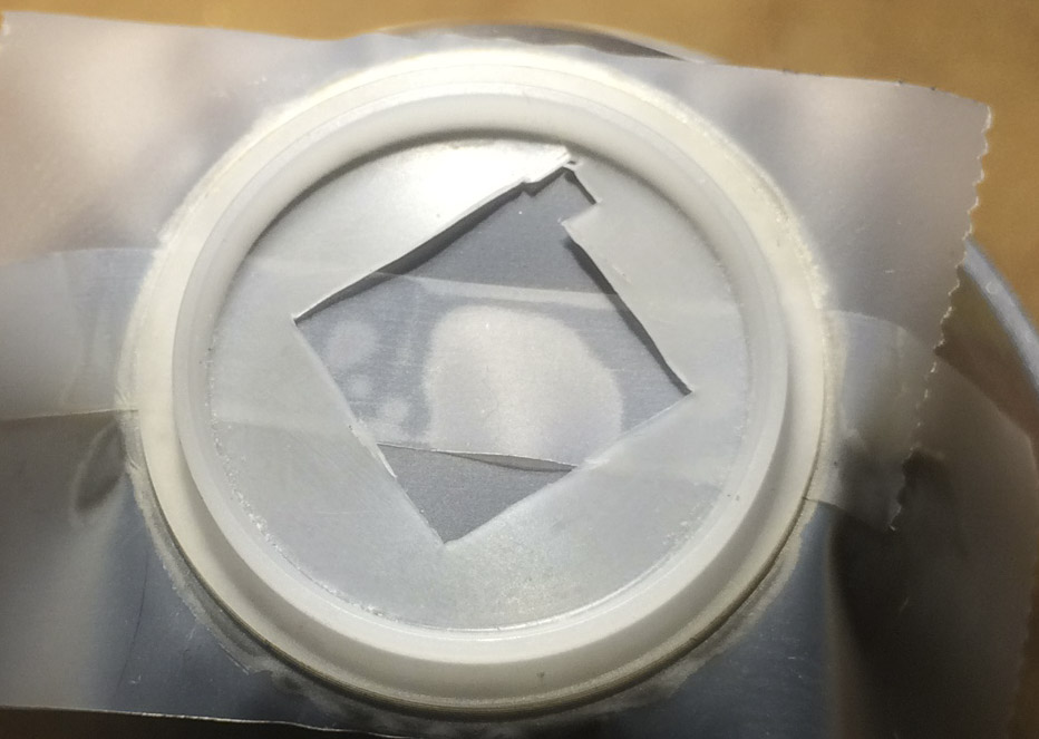

Sanded the piece like the GT centering bar, and cut out the LED and temperature sensor

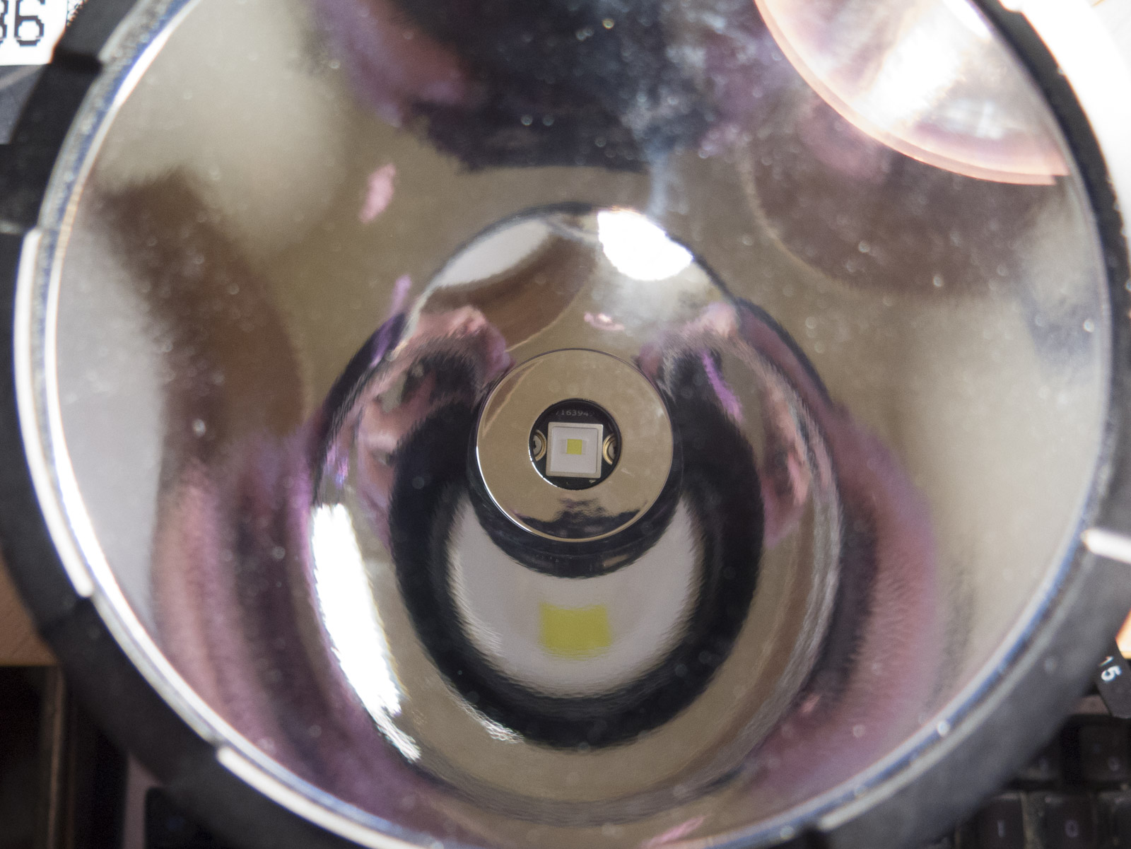

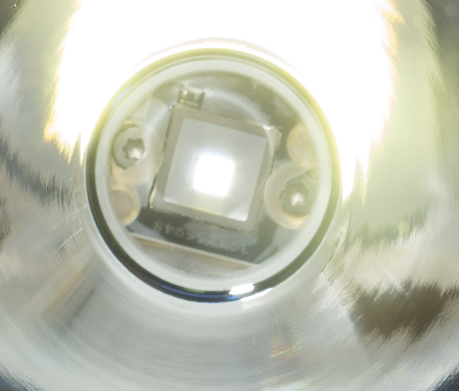

having a quick look on the reflector I am not sure if the gap to the LED wires will be enough not to make a short
Also the head needs electrical insulated from the carriers ground
So I made the holes bigger and will use Kapton tape around the screws and a plasic washer to insulate them
centering piece glued to the LED

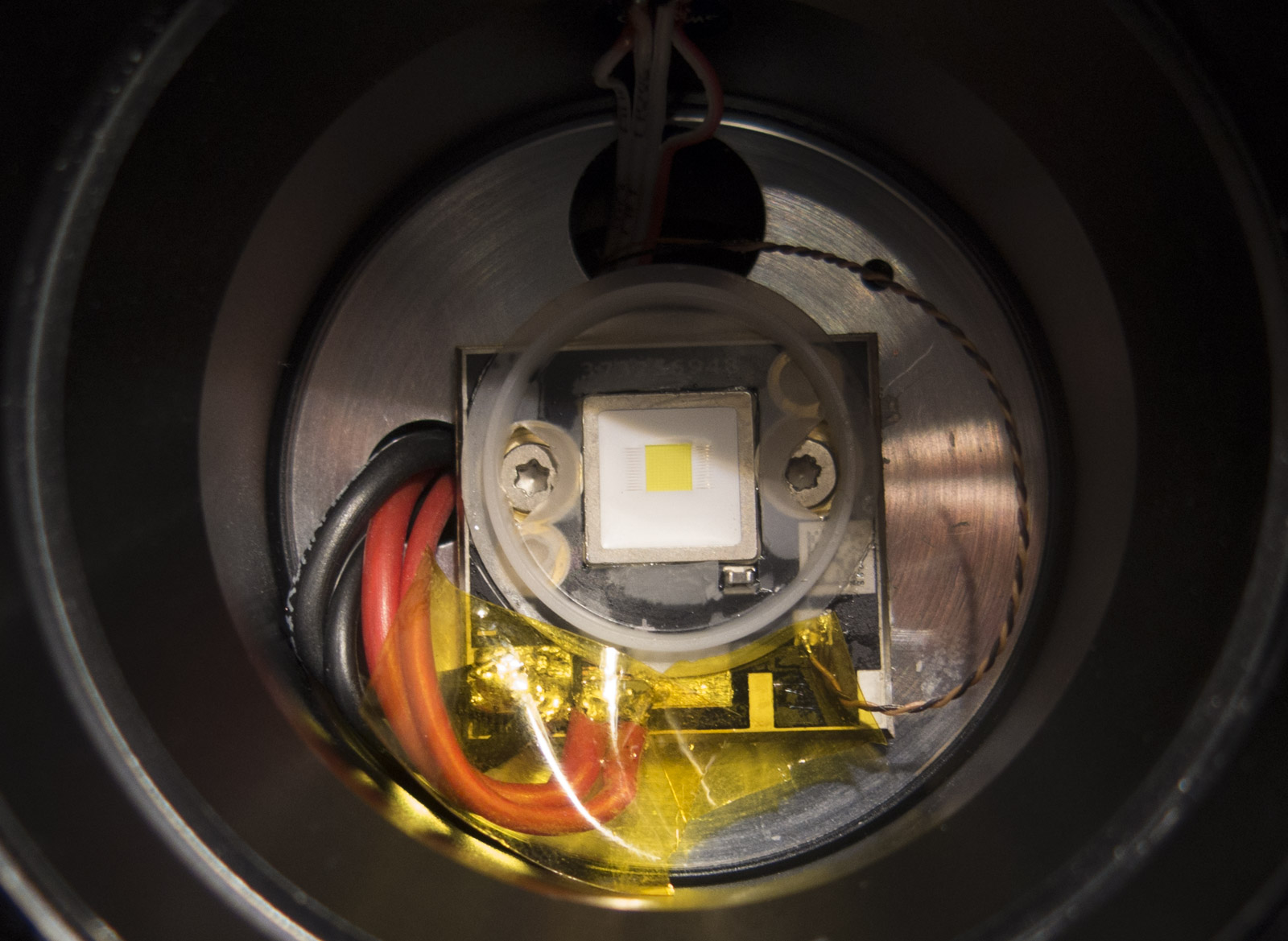

Soldered 2.25mm² wires to the MCPCB and mounted it in the head
I made a Mistake and drilled 2.5 instead 2.1mm for M2.5, so I had to use nuts, but it works

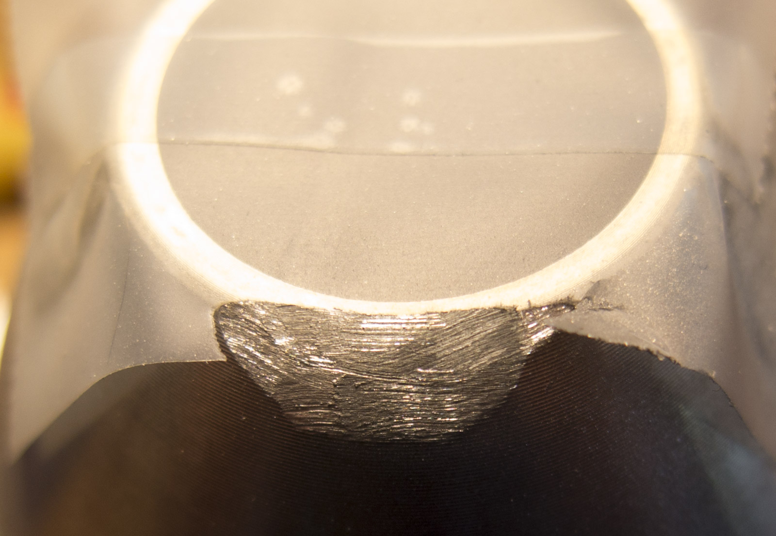

I used my Dremel to got some material on the reflector removed, where the LED wires are and insulated it,
but it seems the reflector can rotate in the head not touching the LED wires, so for safety I will make this all around the reflector base
first test with my prototype driver
