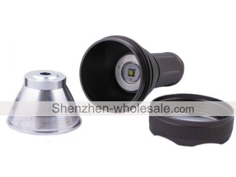

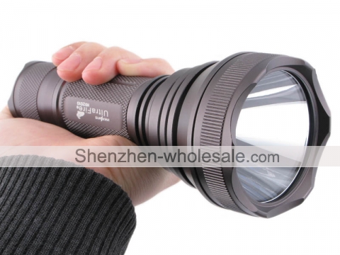

Here is the ultrafire version.
It looks good. Short body thrower on 26650 cells.

It also says the reflector diameter to be 53*40mm.
The battery side of the pill looks non-standard. It could be a nightmare to mod unless the driver is separate on a secondary step inside. Looking at the pics here I cant see that a double sided (i.e. 8*7136) driver would fit. I guess we won't know for sure until someone gets one and disassembles it.
EDIT - On a second look perhaps an 8*7135 would fit. The visual scales are very deceptive because of the large size of the head.
I followed your link to check out the back of the driver and there are no shots showing it, just the battery side of the switch. Duh! I looked again and see it now. Don’t know how I missed it. Definitely not going to take a double-sided driver like the 8*AMC unless you can forego the ring and solder the driver directly to the pill but with no brass that will be nigh impossible to do so reliably.
To my eye, from other pics, it looks like the pill is a standard C8 jobber. Looking forward to finding out. I'd love to see the C8 pill be the new standard like P60 pills are now.

i have a DX aspheric that should be a VERY close fit, diameter and focal length. I'll measure with calipers this weekend.
I am not quite sure about the reflector diameter, if the head diameter is 63mm I doubt the reflector is 53 unless the walls of it are too thick, but lets see when Night breaker gets it, or now knowing 26650 will work, it is a good buy in my opinion in case you are decided to get it dthrckt.

...why does the picture of the flashlight in the hand look like it is more like a 100mm bezel size rather than just 63mm
