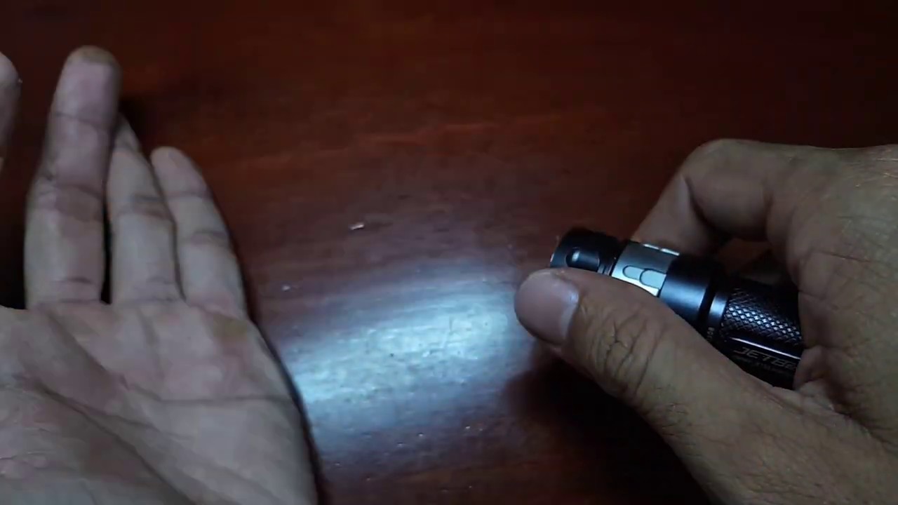

Athlon2350 posted his mod on Facebook and I thought it was cool! I was able to convince him to let me post it here.
"Must turn a copper round to fix hole in body."

I see a POS SF clip so the holes of the clip are compatible??
