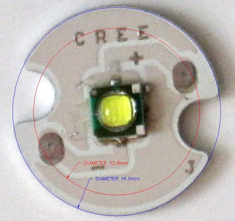

Here is what I get when I size this in AutoCAD for 16mm edge to edge and then show a 12.8mm diameter outline for what would be trimmed. See any issue here?
Looks like there isn't much room for centering error!

I say it is go! Use a pencil and lay a scribe line. Use a machinist trick by doing half the circle, go slow, double check with calipers to the existing opposite diameter. When satisfied, finish the other half.
It's actually not that hard to do. I have done several and only messed up the very first one by letting the tweezers slip and de-domed the XP-G.

I am not knocking reflowing but in a one time single application trimming a star works and is a viable solution.
