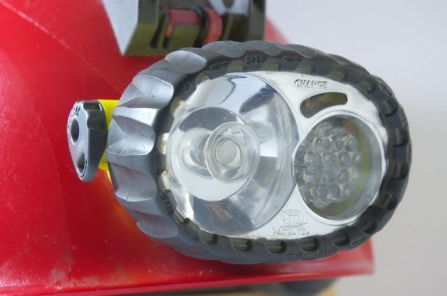

Duo with default halogen buld and moduled 14

The bare xpg flood is actually pretty good but the bezel casts too sharp shadows for my taste plus there seems to be color artifacts near the edge. So I put some scotch tape on the inside and a cheap plastic DX lens on the outside. I used a thick two sided tape that is translucent and glues like hell but can still be removed without a trace.
Now the light has uniform color and slight forward bias. The bezel shadows are very soft and I can see them in the corner of my eye only if I stand by a white wall.
