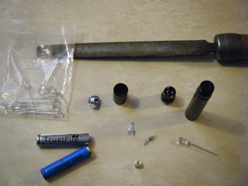

First things first order this pack of LEDs from KD about a month before you plan on doing this mod, you get 10 for $1.92 so if you mess a couple up no big deal.
http://kaidomain.com/Product/Details.S001105
You are also going to need an unprotected 10440 to power this, so once again KD to the rescue.
http://kaidomain.com/product/details.S000974
Necessary tools: File, scissors, and a needle nose or some hemostats.

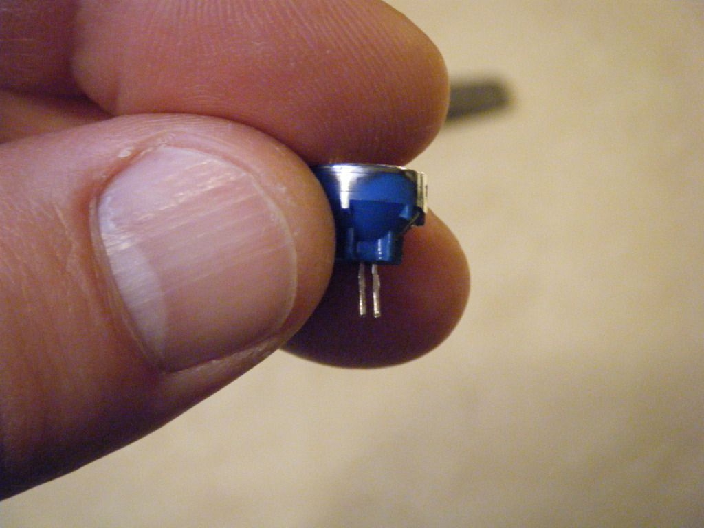

Here is the old girl ready to start her second life as an LED key chain dangler.
Let's get started here is a mess of tools and parts on the counter, don't let your wife see this.

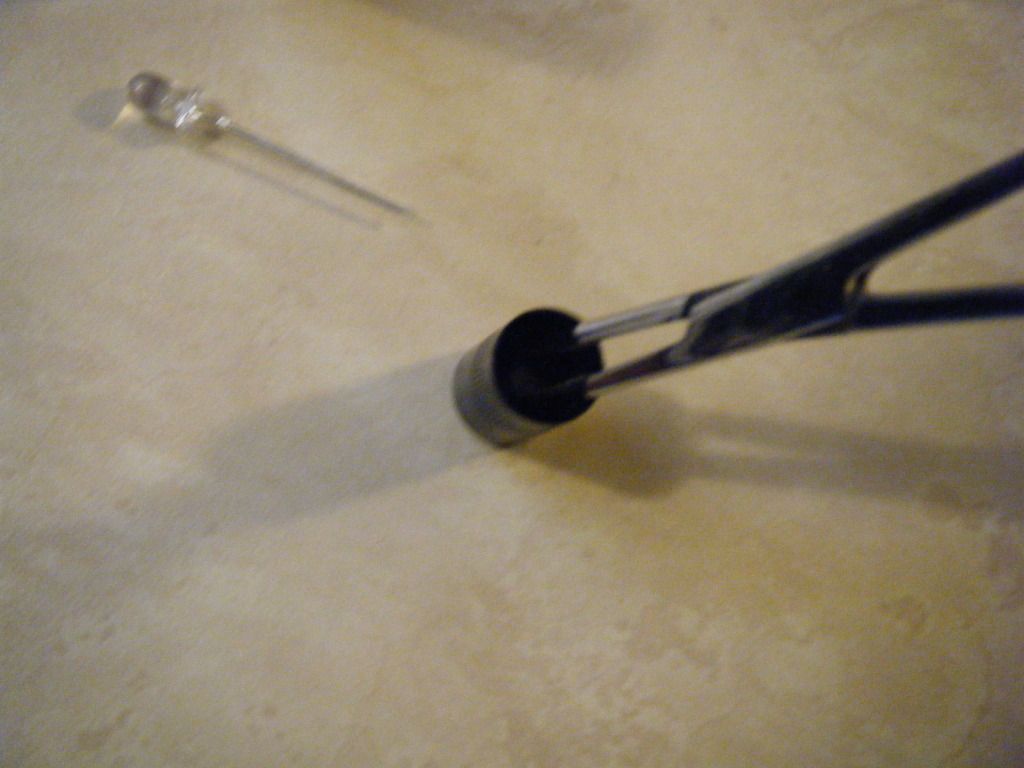

Hardest part of this mod removing the reflector, they can be a bugger to get out. I grabbed mine with some hemostats and it pulled right out.

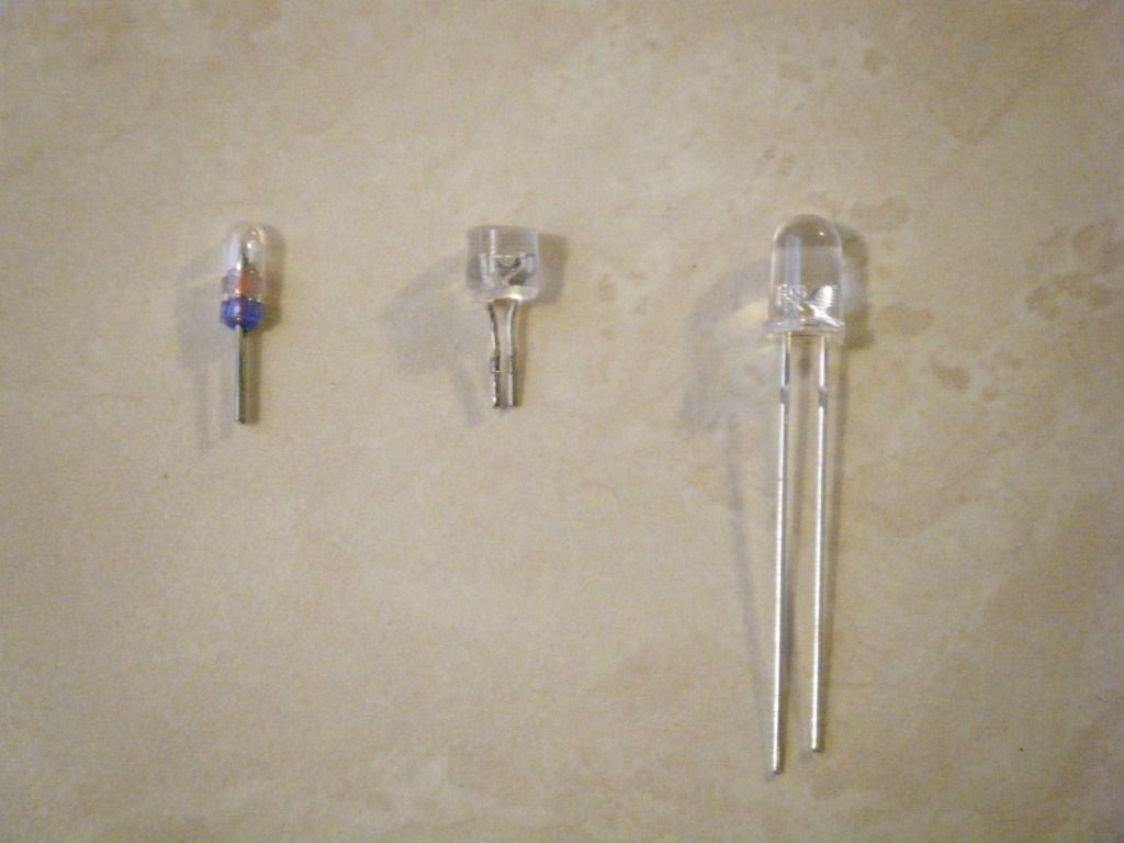

Next comes the time consuming part of the mod, filing lots of filing. The first thing you want to do is file the bottom of the LED. You want it to almost come to a point were the power wires come out the bottom because the LED is going to sit inside of the reflector.
More filing this time we are trying to shorten the LED and give it a flat top. When you are done you want it to be even with the top of the reflector.

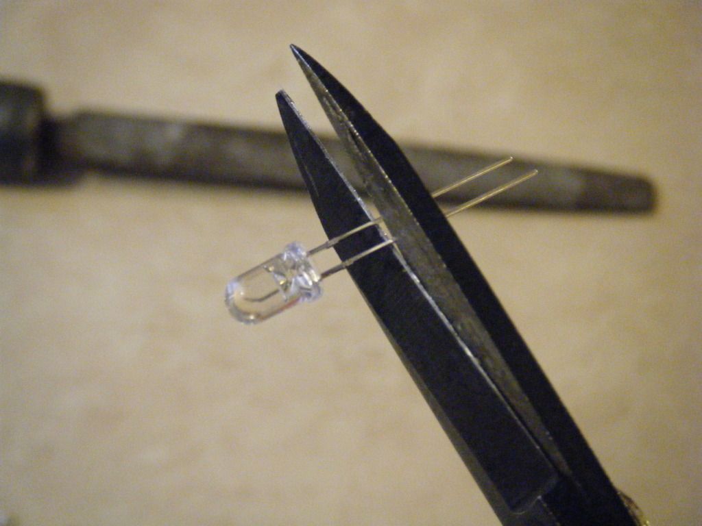

The final mod to the LED is trimming the power leads. You want to save this step for last because the power leads are very useful for holding onto the LED while filing it.

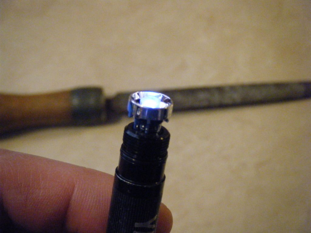

This is what the LED is going to look like when it's finished. Notice the bottom is angled inward and the top is now flat.

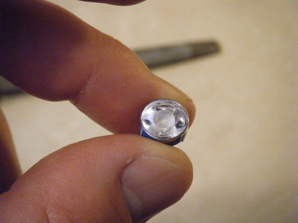

Here is the LED in its new home you want the top of the LED to be flat and flush with the top of the reflector.
Here you can see the LED does not stick out at all past the top of the reflector. This is key because you don't want it pushing a hole through the plastic lens when you shut it off.
Once it's all trimmed and filed insert your 10440 battery and give it a test run. If it doesn't turn on try spinning it a 180 degrees since the power leads are directional.
Here is the finished product in all it's glory ready for another 400,000 miles of dangling in the breeze.

Very nice, E! How bright is it? Have you popped it on the IS yet?
It's about a million times brighter than a stock Solitare which is not saying much. It is all flood, very useful for a key chain light.

Looking at the pic where you have the original bulb and the filed-down LED, it looks like the filed-down LED is wider (diameter) than the original bulb. The hole in the reflector is really tiny…just about the diameter of the original bulb.
So, did you have to reduce the diameter of the LED more than what was depicted in that pic that had both the original bulb and the filed-down LED? If not, how’d you get that larger-diameter filed-down LED through the reflector hole?

I did not drill the reflector that is why I filed a taper on the bottom of the LED. Just push the wires through the front of the reflector and taper the bottom of the LED with a file.
