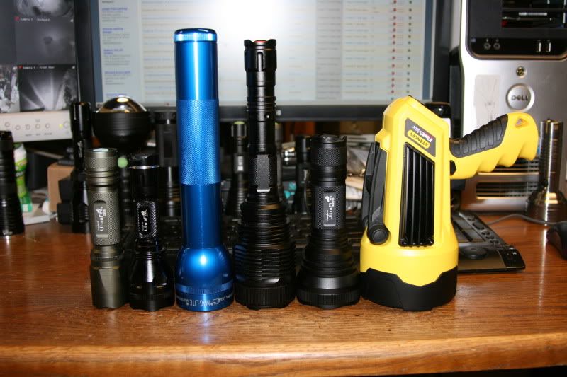

First, the contenders. All beamshots are in this order left to right and the group shot is in the same left to right order:
From left to right, with drive current measured just before shooting, they are:
UltraFire C308 @ 3.5A
UltraFire C8-A1 @ 3.45A
DX V8 drop-in @ 2.7A (calculated)
xxxFire D1 / DX V6 5000K @ 3.0A (calculated)
HD2010 @ 3.7A measured
Stanley FatMax XML @ 2.7A (calculated)

thanks for sharing, whats that big thing with ashperical lens at the back ? :stuck_out_tongue:
Where to buy? International here…. :smiley:
This would out throw the TN31 and SR90. Possibly the SR95 UT.
Aw shucks….looks like its not. I thought it would be at least 4 inches for the reflector.
