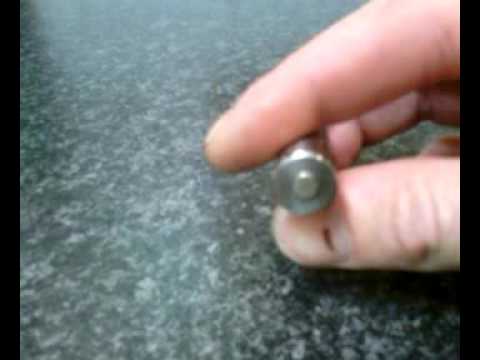

CRX - āThis video is privateā?
Itās not very good anyway! My first video attempt just showing the light working - see it now?
Yeah, I see it. What did you do? Those pictures donāt tell the whole story!
Itās a secret
- just kiddin
I drilled a 5mm hole in the endcap, drilled the shelf out the extension piece and installed one of those round 10mm omten switches with a couple of magnets on top and a piece of poly tube around it.
Not finished yet but i thought iād show.
Itās a fairly easy mod if you get the extension with the hole through it then you only need drill the endcap.
This mod might be more functional with the fairy or spy as there would be a covering round the switch and that would still leave an attachment point but you would need to still twist the head for modes.
Nearly forgot - the reason itās a three mode and works the way it does is because the driver is from the new DQG Hobi Plus which operates differently from the older models.

Yeah iām surprised how well it went, just found out it can stick sideways to metal objects too.

How long is it? Please post photo along with AAA battery if possible and/or with original Hobi. Is it SS or titanium?
I think you should add some plastic pipe/heat shrink or cut to size PP foam around the magnets to immobilize them so they would not move in case the flashlight is dropped.
ā¦or just replace the magnets with a metal post that has a flange around the bottom so it canāt escape the tail cap.
Thanks, yeah a smaller factory switch designed for it could make it at least 5mm shorter.
:laughing: 35 views and countingā¦
Titanium version, easier to drill than stainless steel iāve found. Best to saw off the post before drilling.
The magnets are epoxied to the top of the switch, canāt move and strong enough to hold horizontally.
That was my first thought but i had nothing suitable in my parts box.
I really wanted to keep the post with the hole through it so it could still have a keyring attachment, i might make a post with a hole and flange at a later date, that would be cool.
I have the switch epoxied in place, an o-ring under the polycarbonate tube at the switch side which is compressed to give a tight fit when assembled.
Iāve left the tube removable for now.
The switch post has some lubed spare o-rings on it and offers a half decent seal against the inside top of the endcap - it can take a quick dunk.
Edit - Added split ring attachment

Haha, patience, just order up some 10mm round switches and play around with the idea.
I was not really concerned about making a mess of the endcap because i had a spare from one of the pill capsules i bought a long time ago and could/ still can revert it back to original if i like.
Keep in mind though that i have the electronic three mode driver in mine, not the mechanical two mode so you would have to very finely tune yours and still need to twist the head between high and low unless you mod it some other way but i think that would still be ok.
