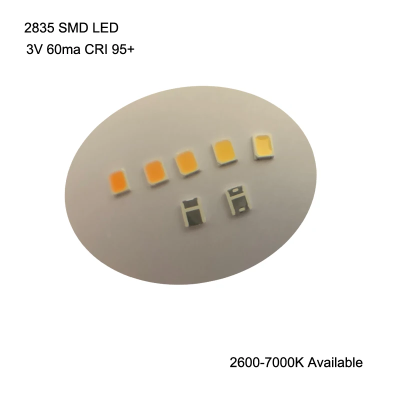

About that CRI 95 SMD, you mean this one?
Yes
