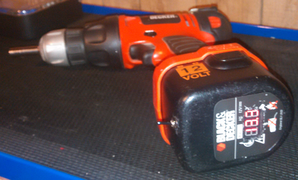

Well, finished the whole shebang a lil while ago. The voltmeter is activated by pressing over it, as the switch lies just behind its PCB, glued over the batteries. Overall feel pretty satisfied with the thing, as it's been a tight squeeze inside and I've managed to glue the batteries at the right distance for it to work nicely. The hot glue at the sides of the voltmeter outside of the tray makes it hard to press the thing, good because it draws nearly 20mA while in operation, makes it hard to leave the thing involuntarily activated.

Well, I'm quite satisfied with the tests, my friend quite likes it! The overcurrent protection trips a bit soon, though. I mean, as a drill, you have to be carerul as to avoid too harsh of a start-up or any other over-torque situations. As snakebite said, the overcurrent protection tends to trip a bit early.

Not fully tested yet, but the very little no-load voltage drop with the drill fully running (≈0.16V) tells me the stuff is working as it should.
Massive torque available now…
