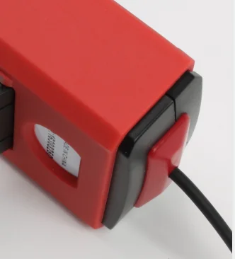

So, I have contacted all stores (6-7) currently selling Tasi 8133 on Aliexpress, asking them which version they have. Some like frank hu, honestly reply they have only the black one.
Still, one replied that they have the red-capped one and sent me a picture. The store is Ali World Shopping Center.
So I want to ask you:
1.Has anyone bought a bad TASI 8133 from this shop?
2.Are the serial numbers the same on all TASI 8133, good or bad ones? (I’ve seen products from China with a single serial number for all units in a batch before)
3.What is your TASI 8133 serial number, djozz? The one on this picture seems to be 16303260(?).
Notice the darker red color of the cap. Is this normal?

The dark red bit is what mine also has. The serial number of my TA8133 is different: 17001457.
I guess that you have the ok quality version, but to be sure you can check how the inside of the sensor is build, see post #2 and post #30. (If you just take a look and do not mess around inside the sensor, it should not affect the calibration).
