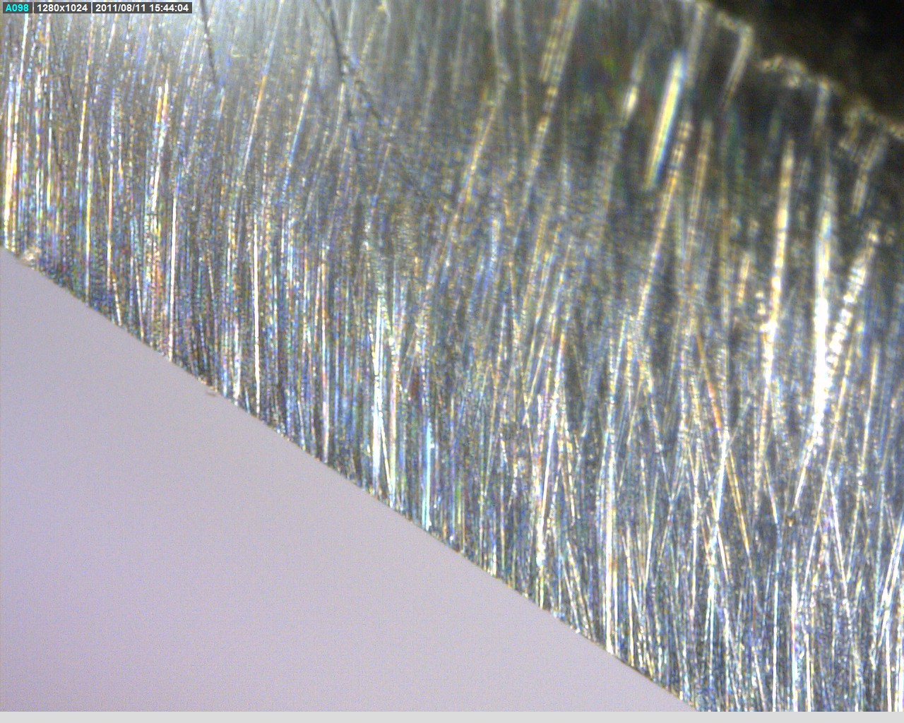

One could even get a 500X USB microscope and be amazed at the difference between a diamond compound and whetsone etc.
http://sharpeningtechniques.blogspot.sg/2011/08/side-by-side-comparison-shapton-stones_9749.html#!/2011/08/side-by-side-comparison-shapton-stones_9749.html
With 15k, and 230X mag on a USB microscope.

Cool pics, 2100.
I got myself a cheap 10X magnifying glass (2 inch lens) with ground glass. Good enough. Those higher mag ones with smaller lenses have quite a lot of abberations at the corners, too small a sweet spot to be useful.
The software demoed with the USB microscope was interesting, especially the length and angular calculations.
Shame about the real-time delay, as it prevents its use as a soldering microscope.
