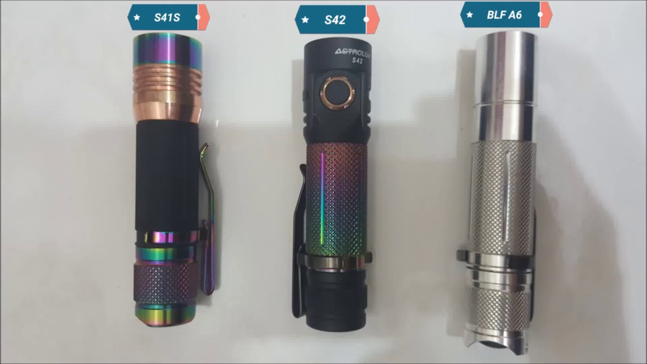

sure :sunglasses: here you go :smiley: but warning it’s a low quality beamshot just for fun :stuck_out_tongue:
I find the beam of the A6 MUCH more useful than the S42. It seems brighter in person due to the beam profile (at least it does to me), but probably the S42 has slightly more lumens
I’m not sure that Astrolux has better CRI, Yes, CRI is better, but D4 has a much better tint.
Actually it does:
Yes, I already found that post.
I have the S42S (which is a SS version with a copper head), and the BLF A6, and the S42S is definitely brighter. However, you’re right that the A6 has a more useful beam, especially for outdoors. The S42S is extremely floody, and doesn’t have much throw. Great high CRI tint for indoors, or outdoors at modest distances. But I wouldn’t carry it outdoors if I needed any throw. The A6 has a very useful multi-purpose beam: floody, but with some useful throw.
Each light has its purpose, but the A6 is a more typical EDC light. I find the S42S is more of a “wow” light (with the Nichia 219 option), but not as good for EDC.

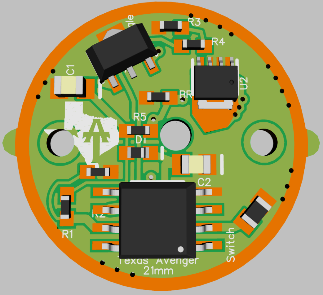

I need the precise dimensions of the S42 connection board holes
as well which voltage goes over the 2 rods and if another connection of the MCU board is required
just want to leave charging, but the old MCU disconnect so it has no standby current of 1mA because the breathing mode
I am so far with a driver, but cant finish it without this information

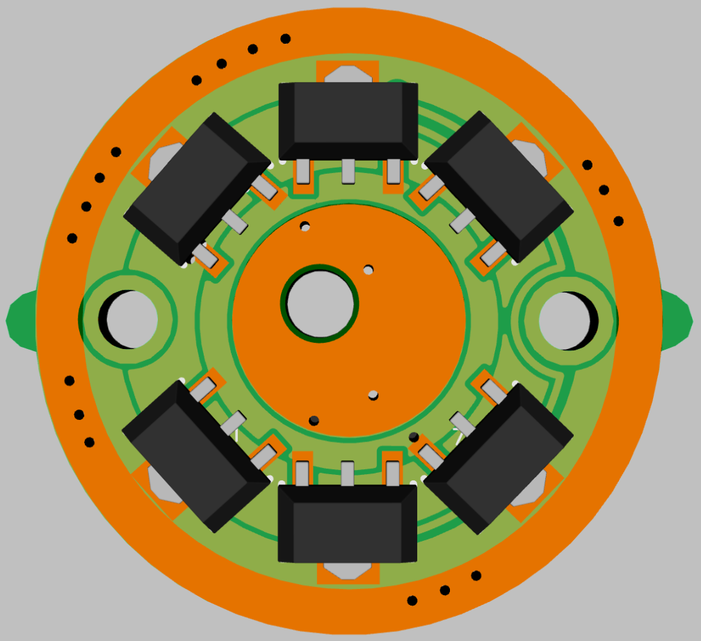

Astrolux S42 driver designed
Running NarsilM
FET+6+1
sale topic
cool!
