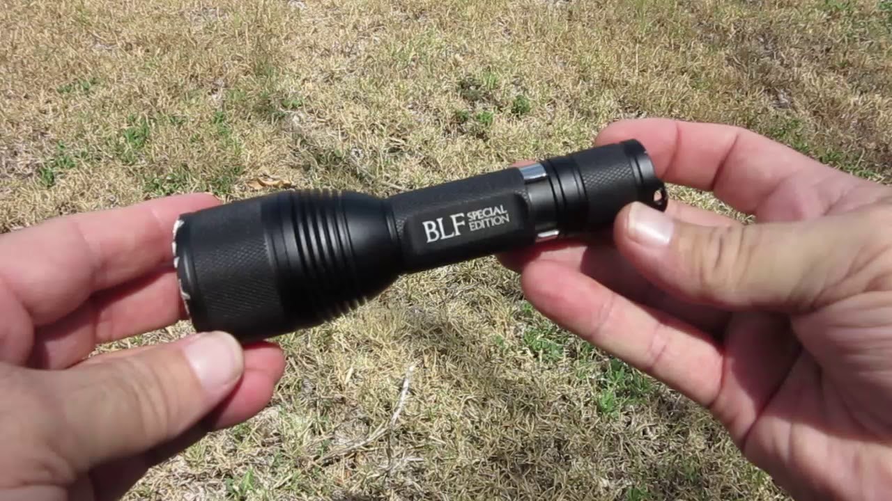

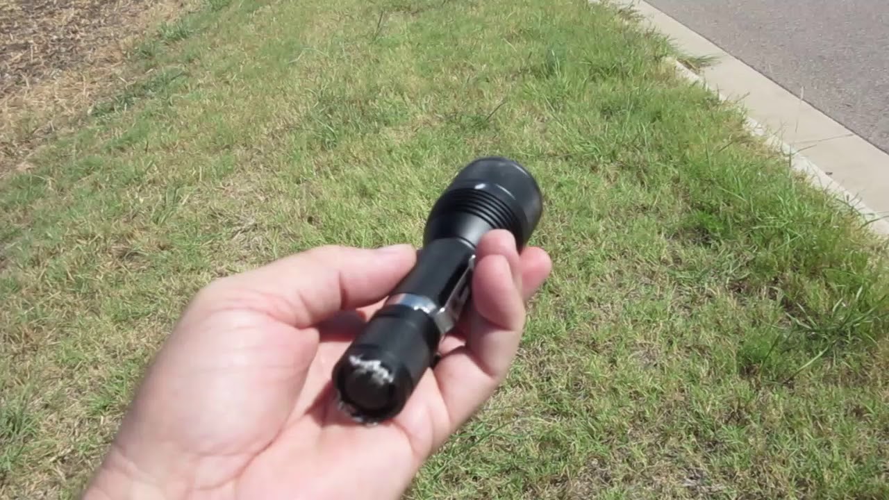

Well, I probably forgot what actually happened in the X6 road test… the cell compressed the cell to it’s max and then dented in the top of the lap pull cell. This made it too short to reach the spring, so between some spring collapse and the dented cell the light wouldn’t work. I still have that cell and that light, both still work. But at the scene, under an extreme duress, the light did actually fail.
My thought to do the test was remembering those times something got left on top of the car, or on the toolbox on the truck, even on the bumper of the truck after looking underneath. So the 60 mph test was an extreme real world possibility. The light survived, took very little to resume working condition. Again though, had it been potted it might not have been repairable.
The Type III ano actually survived sliding on asphalt quite well, the major damage came when a pebble in the surface started the light flipping and it rebounded into the air then impacted very hard at landing. Comparatively minor damage even then, but the sliding action that could be heard in the video did virtually nothing to the light.
