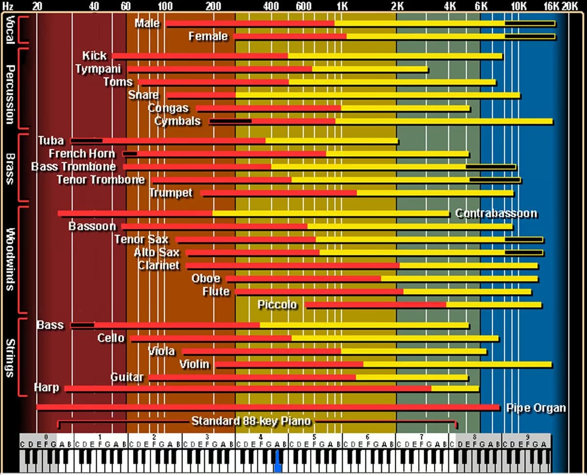

As far as music goes, the lowest string on a bass guitar is 42Hz. Organ and big grands reach lower.
Movies plumb the depths.

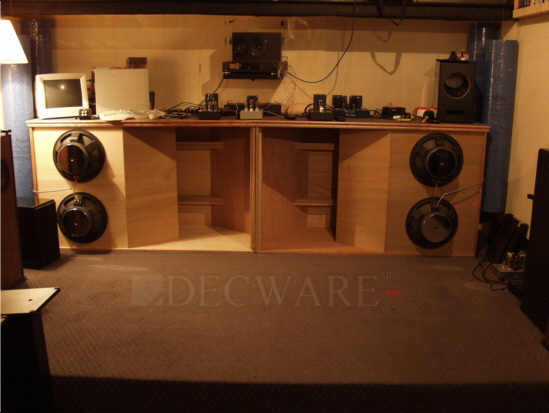

My sub? Just took my 24" Hartley in a 68CuFt transmission line apart because of a move.
24" sub? That must be epic! :smiley:

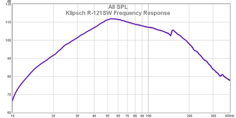

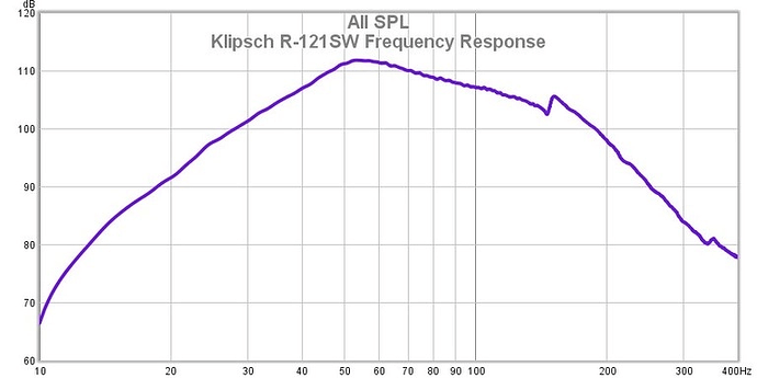

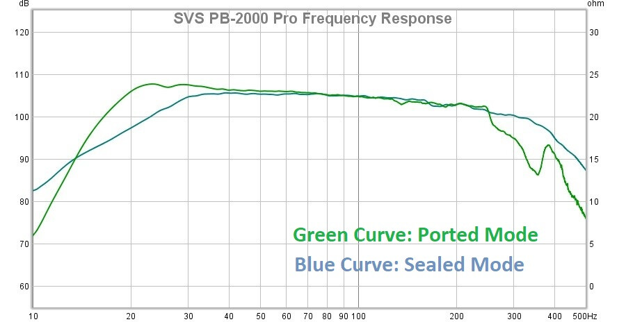

Sure a sub may reach 20Hz, but if it only produces 90dbl at 20Hz it won’t be felt (much).
For example here is the actual responce of a 12" Klipsch
vs an SVS 2000 pro
Guess which one I’d rather have? :wink:

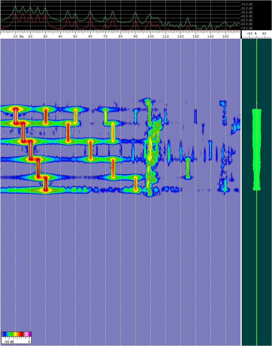

Using the REW software you can send any freq you like to your receiver.
Lots of fun to see what the speakers can really do.

It’s a funny thing about all these statistics and measurements ---- If the music doesn’t go below a certain Hz as stated above — Put a high pass filter at 10-35hz, see if you loose any sound or realism in the sound

Yes, but some will argue that there are harmonics and some instruments, like synthesizers and pipe organs, that do go as low as single hertz. In any case, the LFE, used for explosions, gunshots, thunder, etc, do go well below the 35 Hz that you mention. Now finding a sub with decent output that low is a different story. They tend to be big and expensive. And, of course, getting them to do that in your room is where the optimization comes in.
