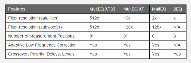

Based on a graph I found comparing the correction curves generated by MultEQ and MultEQ XT32 versions of Audyssey, there is a drastic difference in the resolution of the changes made between the two. Since I have a version of Audyssey that’s even lower than MultEQ I’m sure that the resolution of the room correction is even lower for my system.

The post I found comparing room correction softwares did have measurements for room-corrected output though, and the graphs show that the middle version MultEQ XT does a really crude job adjusting the lower frequencies.
This table is extremely helpful, I’m surprised I never found it referenced anywhere in all the discussions I’ve read. Based on the table, my fears about the subwoofer filter being worse than MultEQ XT are unfounded. It’s exactly the same. So not great, but at least not worse.
I do have questions about that 2x resolution for the satellites. I wonder if it counts Front L and Front R as satellites?

Thanks for taking the time to reply and for tracking down that table. It ought to be front and center on the product descriptions of every AVR with Audyssey. Gonna head to the Audyssey site and read everything and hopefully learn what that 2x resolution means for the end user.
EDIT: Now if I look in Google image search I can find that table but I can’t find a corresponding article on the official website.

Found this discussion:
The Audyssey rep links an article which no longer exists. Probably that is the source of the table. He answers some questions in this thread though :+1:
Audyssey rep:
Yes, “satellites” refers to all the speakers in a system other than the subwoofer
16x means “16 times more”. We don’t publish the exact resolution of the filters. MultEQ has dozens of control points (many more than 16). MultEQ XT has hundreds. MultEQ XT32 has more than ten thousand.
So maybe I don’t need XT32, but I would probably be better off with MultEQ XT :thinking:
