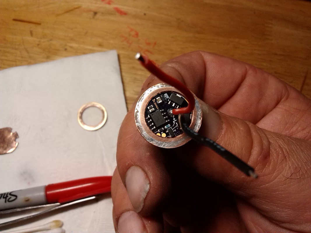

will removing the plastic cover and using longer copper battery adapters instead of the plastic ones probably be a bad idea?
Maybe something like this using copper sealing rings…I have made a few adapters/sinks for Linear drivers… just sinking off the ground ring, as high as 12amps no problem…

JasonWW
(JasonWW)
76
I dont know what a copper battery adapter is. Do you mean a sleeve to center a smaller battery diameter? It would not do anything other than add weight.
hank
(hank)
77
You don’t want to remove the insulating plastic and replace it with electrically conductive copper.
That would be bad.
BOMBAY
(BOMBAY)
78
ok thanks i just thought it would be a bad idea
JasonWW
(JasonWW)
79
That’s exactly what everyone is doing. Can’t be that bad.
Dr.Phillip
(Dr.Phillip)
80
Well, if you are worrried that you may short the battery positive to the body negative, the shape of the copper should prevent that in all standard battery formats, plus I am considering coating the exposed copper on battery side by insulation. Either liquid electrical tape or some epoxy, not sure which or if jet. I’ll do some measurements, tests and decide based on that. I may not do the coating if I deem it safe for my use. I am talking about the copper insert man of light is designing: MF01 Mini / MT07- Mod/Upgrade - Copper Heatsink Cover Plate
