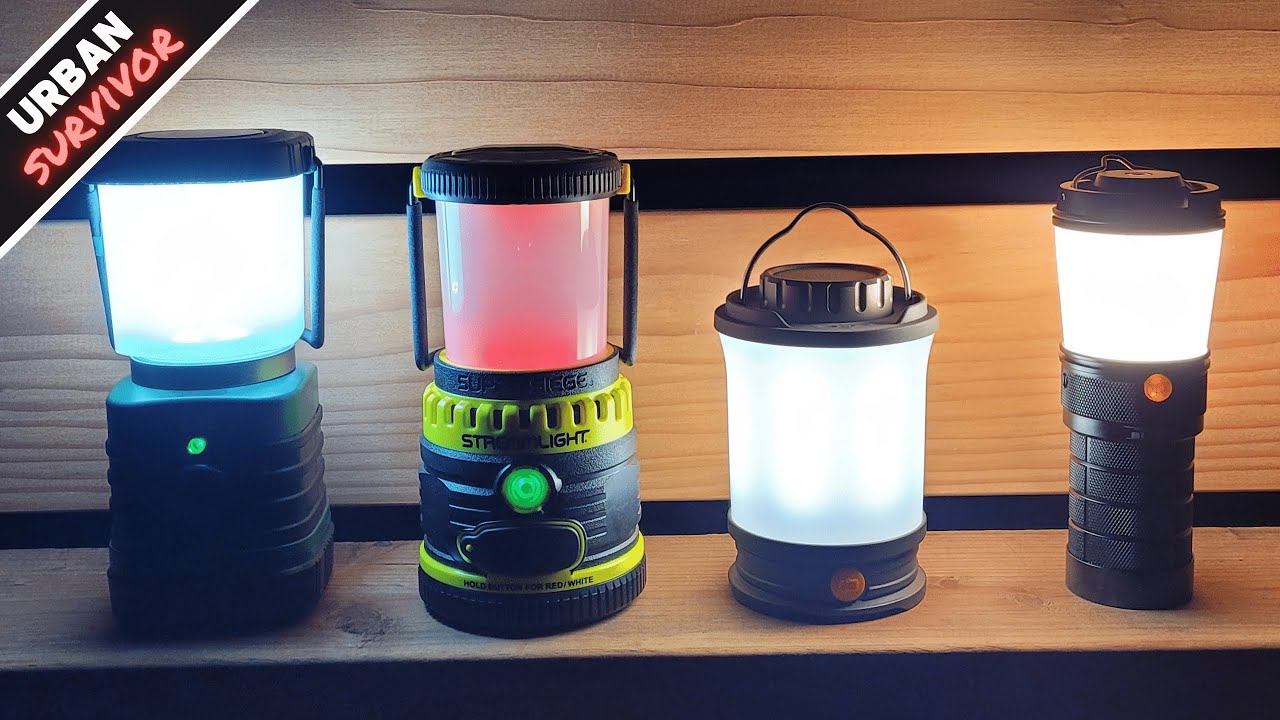

The Best Lanterns Compared (Fenix CL30R + Streamlight Super Siege + BLF LT1 + LE Rechargeable)
Because i have already two Fenix flashlights probably i would choose the Fenix CL30R ! Just my opinion !
