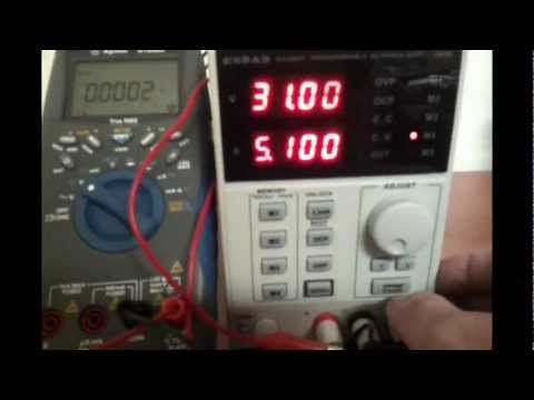

and ordering a KORAD KA3005D, which TexasToasted noted,
it has the rotary knob and is in the same price level I want.
The model is quite a lot of info. about, here are some:

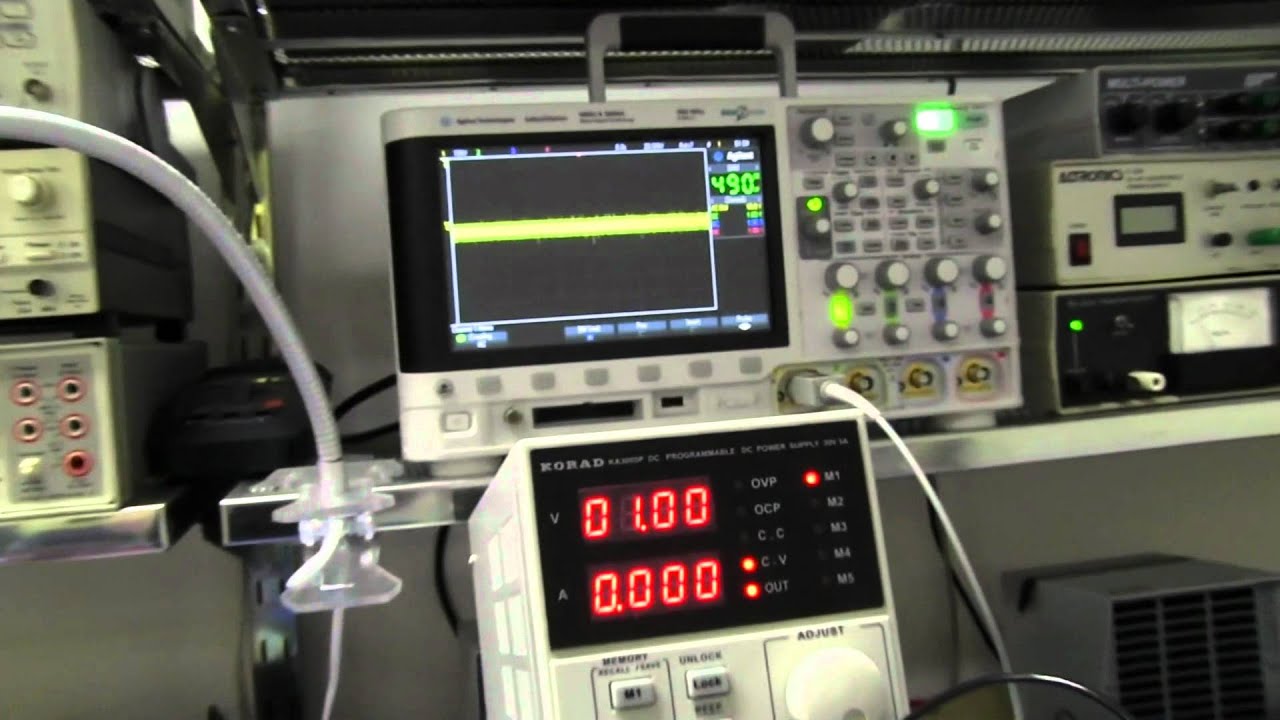

Fan noise fix:

The first time you turn it on, you may be surprised that you have no output. Unless you read the owners manual first, but who does that?
You have to press the Output button just above the positive lead terminal. This lets you turn on the supply, set your current limit and output voltage, then enable the output to the terminals. Very handy little button.
