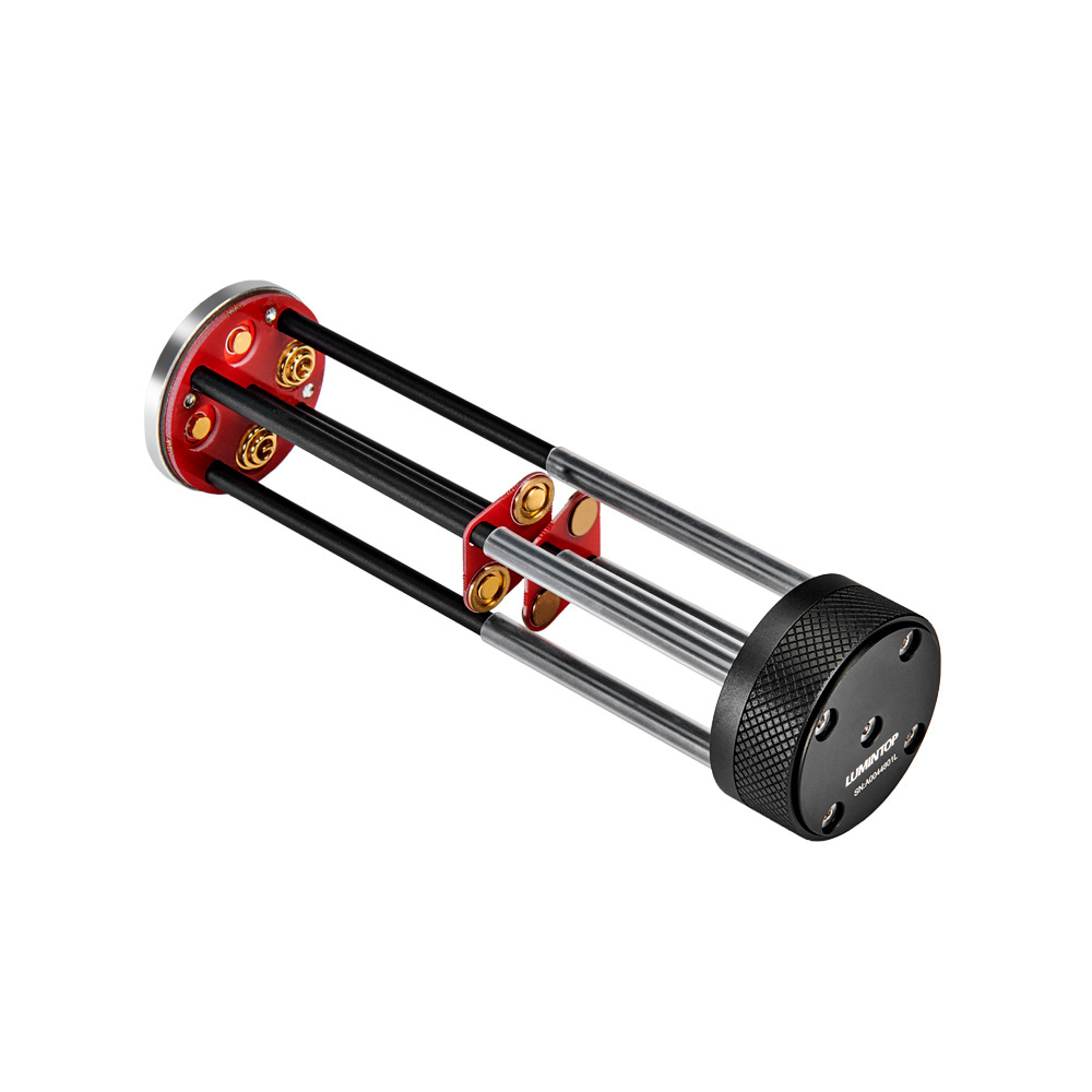

One carrier group of 4 cells were all sitting around 4.0 volts for 16.0 volts total… all good.
The other carrier group had one cell at about 4.1 volts, one cell at 3.45v and two cells over 4.2v! Apparently the 3.45 volt cell was self discharging and as its voltage dropped it was drawing current from the carrier with the good set (higher voltage) and overcharging some good cells! As FlashPilot said, the 4S2P config can cause other issues.
The self discharging cell is going to recycling.
These 8 cells were bought with the GT and only used in the GT… always in the same groups of 4 in the same carriers. Name brand cells shouldn’t do this… even if they are a few years old. These cells were never abused, over discharged, or overcharged.

As an aside, the Lumintop GT4/GT94 uses a single 8 x 186850 carrier with an MCPCB conductor plate sandwiched between the 2 groups of 4 cells. That plate was reported to be problematic and creates cell voltage imbalances… not good at all for a light running 4 x power hungry emitters! Removing the plate resolves the voltage imbalance problem.

Isnt the plate passive meaning isnt it just a piece of copper?
