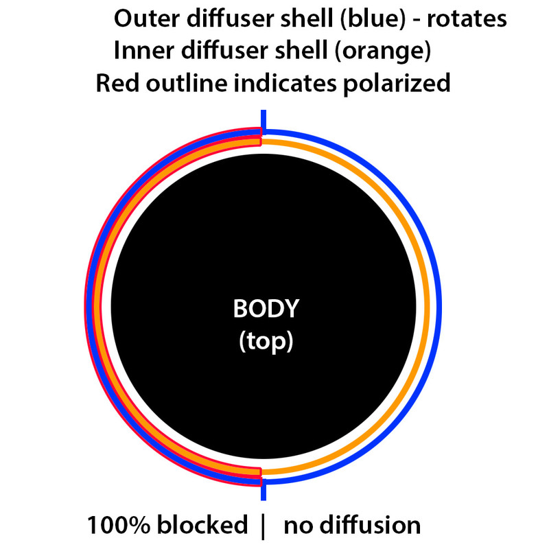

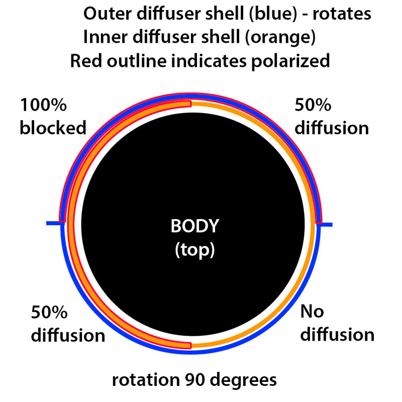

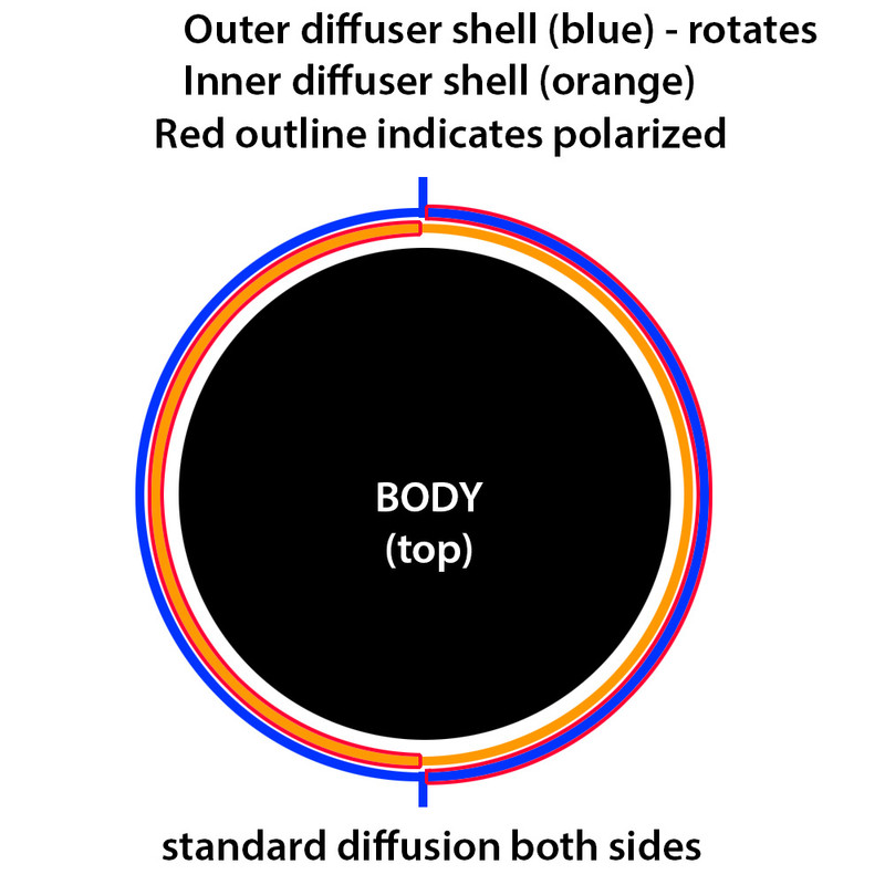

Hope it’s OK to post this… just brainstorming an idea. A kind of “dynamic” diffuser. It has 2 elements: a fixed inner shell and a rotating outer shell. They each have a polarized half where one is rotated 180 degrees. Here’s the visualization:
This is just a “quick sketch.” But hope this can provide a seed bed for an evolved design that might be feasible.

Interesting idea :+1: maybe we can look into something like that for V2 deluxe model in the future.

Thanks! If V2 remains compatible with the same diffuser as V1, then if something like this is designed it would be compatible with both versions. Conceptually, you are controlling the diffusion dynamically, which can be very useful and convenient (no additional objects needed). I’m going to see about getting some flexible polarizing material and try it out.
