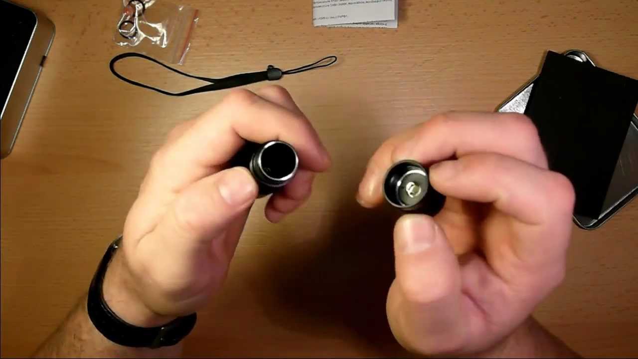

Works very well. Used it often, magnet stayed in until I purposely removed it. If fact I just hot glued another one in after your post! Stays in even if I pull the flashlight straight off fast/hard. Tilting it off of a surface does remove the flashlight with much less force on the magnet plus your likely to do it that way since its easier.
If you really Never want the magnet to come off epoxy will ensure it with no worry.
As for the battery, the spring in the tail prevents any issue with the battery sticking inside to the magnet.
Please could you magnetic guys post some seller's links with the exact magnet model (material, dimension, price, properties) which are best in this case?
i am realizing that the typical Chin*se flashlight body material (alu, SS, titanium) is *not* magnetic. batteries (NimH, Alkaline, ..) are highly magnetic.
( i am testing the magneticity with the feet of my Gorillapod haha )
It must be neodymium. There are strength grades but I think (hope) even the lowest will hold. Larger twisty flashlights might weigh more but they would also fit a larger diameter stronger magnet. Grades are from n35 to n52 (low to high).
Ebay is cheap if you only need a couple low grade neo magnets. Hard to find 2.5mm thick on ebay, you could epoxy a 1mm & 1.5mm together if you want it flush or just go for 3mm.
I'm sure others must add magnets to their lights, no? It also gives you a fun way to store your lights.
<- Yorkshire terrier
Its just stuck on a hidden nail in the drywall. Its not very strong since there is paint & plaster over the nails but it holds.
For the Ultrafire 602C AAA its ~2.5mm thick for flush with the edge of the tail (below flush will be weaker). A 11mm diameter will fit (maybe 12max). If you want to keep the use of the two lanyard holes it needs ~2mm clearance so an 9mm diameter off center magnet will do it (or 7mm centered). I would worry a 7mm one might be too weak unless you go thicker or use a high grade but I haven't tried it. You could also get away with less clearance for a single lanyard hole like the Brinyte & most lights have.
I am using the first neodymium magnet I grabbed that fit. Rectangle 10mm x 5mm x 2.5mm thick, most likely high grade since its from a CD or Bluray drive. (Either from a LPC-815 or PHR-803T) ;)
The hollow part in the Brinyte PD03A is diameter 10.59 x height 3.17 mm according to my digital calipers.
So the my standard 8mm rare earth magnets (neodymium) from DX are a little too small.
The 10mm ones should do the trick. You could stack 3 or 4 of them to reach the needed height and epoxy them together. Or take these ones from the bay of E's.
