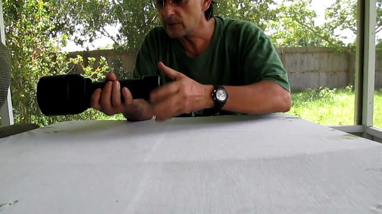

In my opinion the best presentation of an Electrolumens light was from manny, back in 2012, he made a great little video about the Electrolumens Search&Rescue SST-90 light.
Here it is once more:
Oh yea, I remember that vid - really liked it. He lacked in the electronics end but the chunky designs, quality of workmanship were unique for sure.
Thanks djozz. I haven’t seen this video before. Does anyone know who Matty in the video is?
They look like very well built and unique lights. So how did the driver/UI work? Did the two buttons just control two different circuits with different current limiting resistors, or was it more high tech than that?
Can't recall Matty's BLF name, but he was a very active member.
Dunno much on the driver/UI, but from Wayne's comments, the driver circuitry, if it existed, was very simple - no MCU, no smarts I think. He added resistors to control brightness, so probably all DD wiring, some inline resistors.
