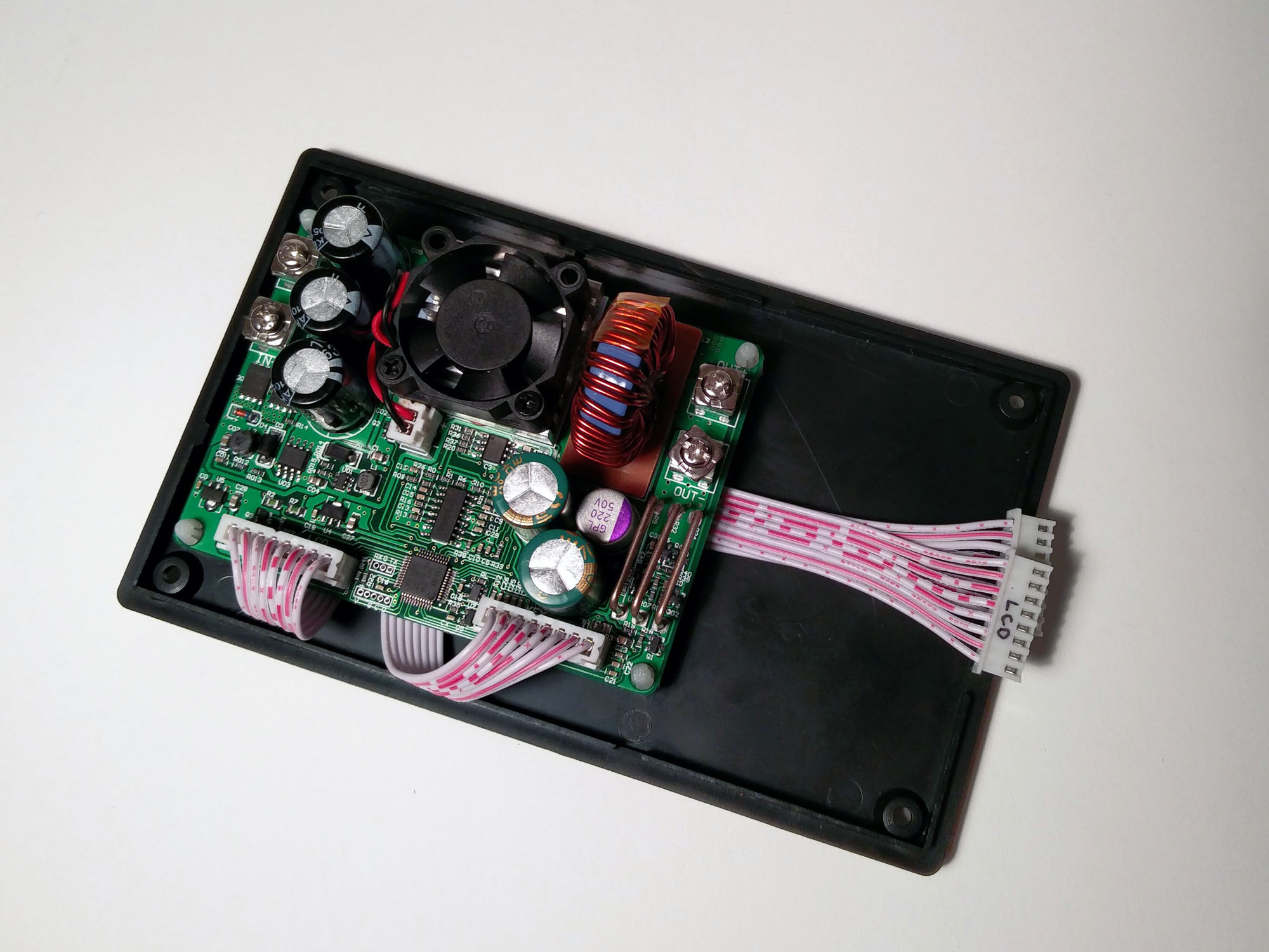

“the device” arrived today :+1:
Very well packaged but the thing itself is much smaller than i though. ![]()
