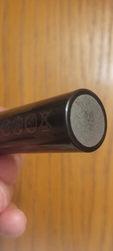

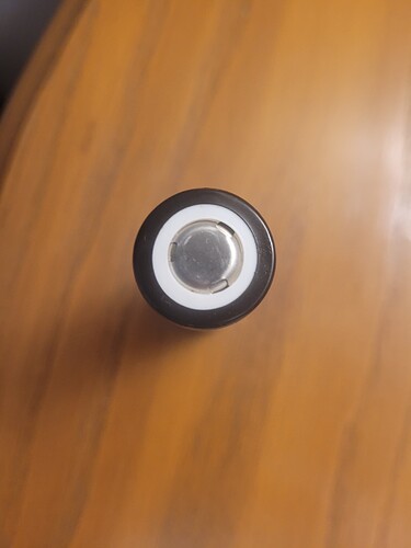

Thanks for the info. I just got these batteries along with my Q8 a couple weeks ago. Does anybody know what batteries under the wrapper now? Here’s a photos of one of my three batteries.
