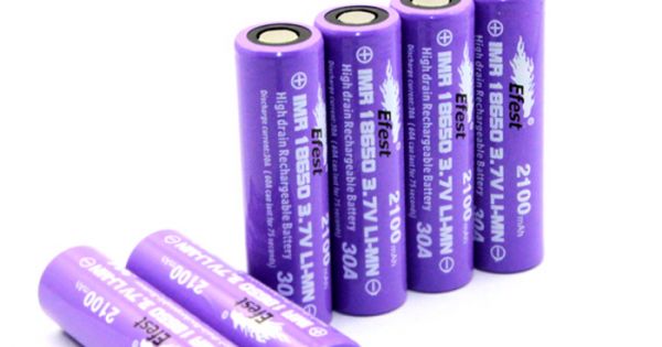

And I beg to differ on the not electronically inclined (2841 in the Marines 92-98)...ohms law to us (especially the guys sub ohming and blowing clouds like a dragon) they are VERY in tune with ohms law...they push 20-30 watts thru those coils and buy the BEST batteries (the flashlights direct competition for those REAAAALY good batteries) in fact many of our folks use the 20-30 amp high current AW's, Efest, and MNKE batteries in their rigs, you would be surprised on just how much they know about batteries and what they can and can't do

In fact if you want to know the latest and greatest on high capacity high current batteries...go ask a vaper
See like this
