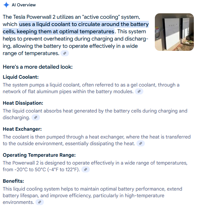

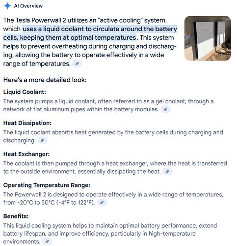

We’ve got a Tesla Powerwall 2 and they went to the trouble of fitting a cooling and heating system in it.
I think general consensus is that it’s unlikely to be dangerous unless you live somewhere anomalously hot, but the expected life of the cell(s) is likely to be greatly reduced.
