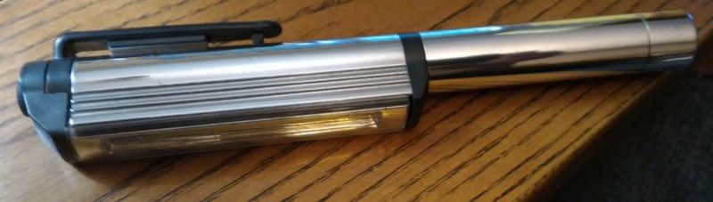

I received my cob lights (from the link in the OP and in Post 5). They are both nice, but I really like the pen light from the OP. It’s better than I expected. The aluminum body is thick and seems strong. I’m impressed with the amount of light this baby puts out. Very even wide flood as expected. The tint and color rendition is great. The light spreads out so wide and evenly, that you don’t have to worry about glare (Like DavidEF’s friends have said).
The magnet on the clip is fairly strong. The tail magnet is pretty weak. I can really see keeping a few of these in my car. Engine problem at night. Stick one on each side of the hood (by the clip magnets) and you got your self a nicely engine bay.
Don’t know what the run time is like yet. Seems like it may not be long with so much output. Will try to see how hot it gets and how long it runs tonight.

Got a pic of the tail magnet? I think it may be in backward. I do not think any of mine are weak on the tail magnet. and I think in comparison the clip magnet is weak to the tail. Tail magnet has a steel surround or a cup. You should be able to see the steel ring around the edges. If not I would say it’s in backward.
Had important things to be doing so I skipped all that and did this. I will be keeping this one. UMMM, its definitely Brighter.
If you need to get one of these apart just get a fingernail between the side of the lens and aluminum and pop it out. Rest will easily follow. Don’t forget the rubber cap on the SW. You will have to take it apart AGAIN.
Appears mine is backwards then. Thanks for the tip. Also, thanks for the tip on how to break down the light.
So, it appears that the LED has no real heatsink path to the body. Unless there is hidden circuitry in the switch (doubtful), the emitter is direct drive with 1.5 ohm resistor bank in series. There are plenty connections and thin wires that add to the resistance. Hmmm, getting some moddy ideas.

would like to see what you do with it. I didn’t count the LEDs or try to see what the potential voltage of the COB is. Nor try running it and check heat generated. Definitely watch the SW wire in the housing slot, putting it back together. I thought to slip some heatshrink in there but didn’t. Yeah, replace wires too, but didn’t. Certainly could add a strip of aluminum behind the COB, there is room with the spring loading the way its made.
after I got mine apart I could only assume my buddy’s light that melted the lens got shorted. Maybe burned a resistor. But his is also the plastic housing…? I will be in CT tomorrow, visiting. I have his replacement. I’ll dissect his plastic version. Spare parts…
