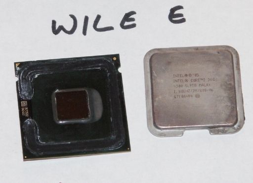

Not sure if applicable for flashlights, but here’s my experience with different thermal pastes:
When I was younger I was really into the self built gaming computer thing. When a high power processor, specially a video card was overclocked and pushed into high loads it produced an insane amount of heat, and can only lowered to decent temperature by the use of a water cooling system or a huge copper-base heatsink with massive fans.
When upgrading from a ceramic based compound to a high-silver one, I noticed up to 15° C drop at high loads. This drop might seem small but it gives plenty of room for overclocking.
BUT, we are talking about a processor which is much more sensitive to temp changes with an area much larger than any LED MCPCB, instant temperature raise on load, it could be idle @40° C and only seconds later at 90° C, this is really when the thermal compound plays an important role. A LED in the other hand is far less complex (greater heat tolarance) and doesn’t heat up as fast.
I have many times intentionally and unintentionally left a light on the highest setting and get an actual burn when touching it, and never killed one, or permanently reduced its output.
So in flashlights, I do think different types of thermal compounds makes a small difference, but in most, if not all cases these differences are so tiny that only exists in paper.
If this is really the case? Why do we all obsess and observe measurable differences when using AL vs CU mcpcb? (Same goes for water blocks and heatsink a for computers.)
Fast heat or slow heat aguement makes no sense to me, it needs to get out.
Even when your computer is idle at 40C, it would be more like 45C if you used cheap thermal paste or applied too much, or had a poorly lapped heatsink, or a small fan, bad enclosure ventilation, etc.
It’s all part of a system that works together and every part makes a difference all the way to the end.
The faster the heat transfer, the better it is for the emitter, driver, CPU, ram, north bridge, caps, whatever it is.
When talking about thermal paste in a flashlight, yes it’s further down the line after the mpcbs, but it doesn’t mean that it doesn’t make a difference.
