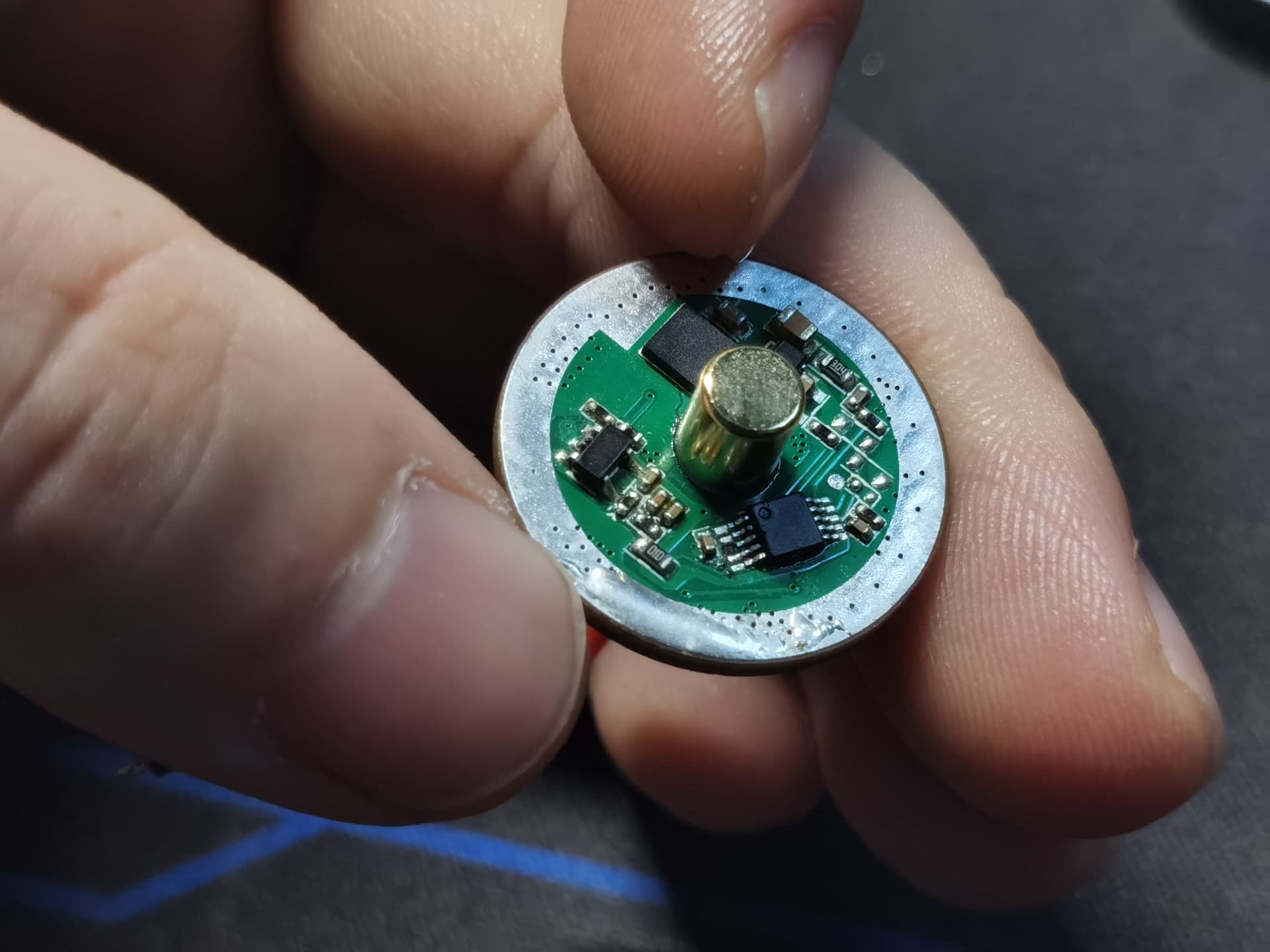

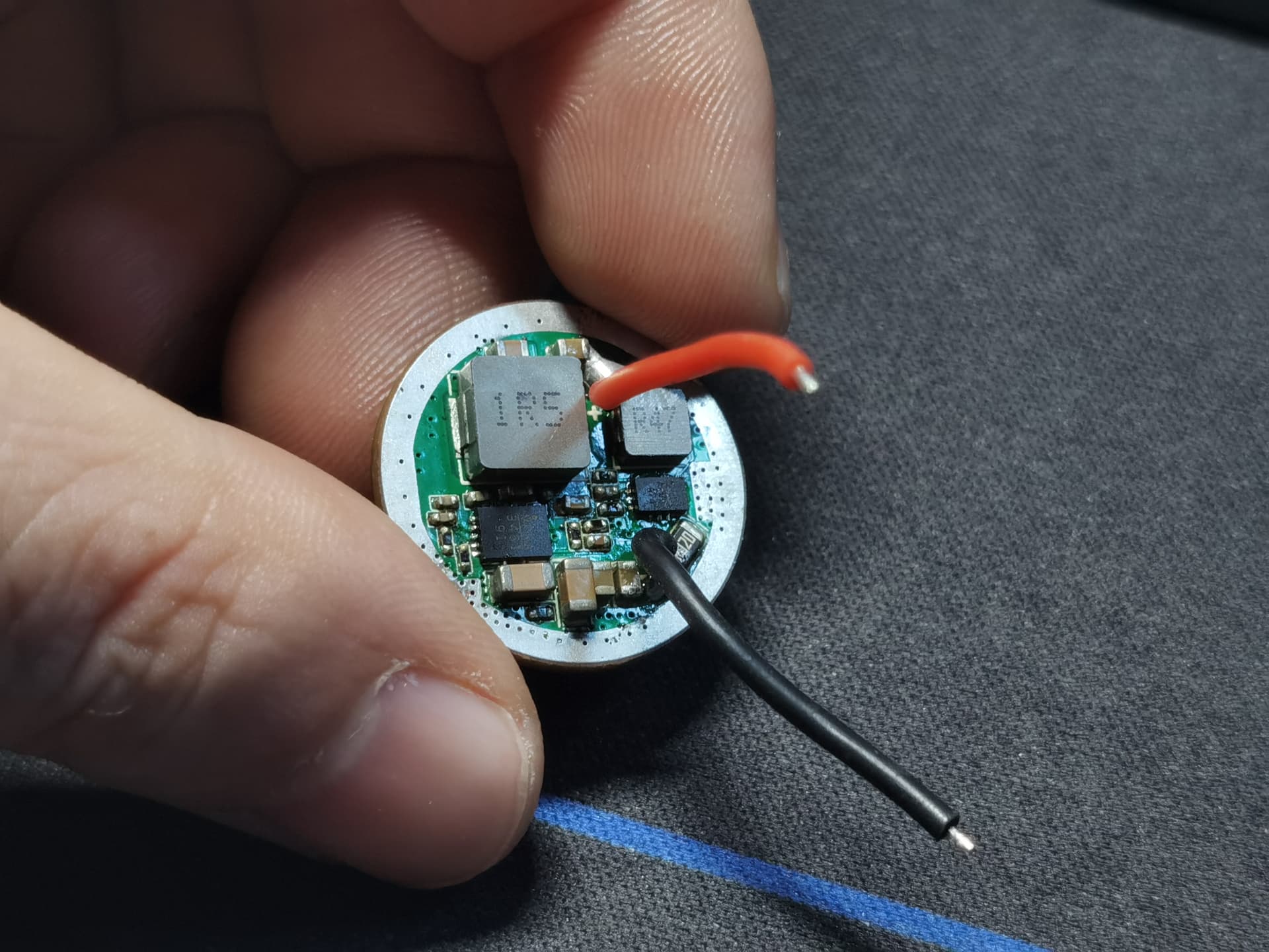

I’m ready to upgrade the driver of S12 with 3*UV 365nm .
Previously I used a linear driver. The maximum current will be 4amps.
The quality of UV 365nm LED is not very stable, and individual flashlights will be burned out.
Because the voltage of ultraviolet led is higher than that of white led.Therefore, the boost and buck functions are added to the drive circuit to ensure constant current output.
18 Thanks
Interesting. The Buck-Boost driver would be nice for driving white LEDs too. What is the parameters of this driver? Current? Voltage range? Diameter?
This sounds interesting for a AA/14500 lights, too!

@Simon_Mao when will the 3X21D constant current driver going to be available?
It will be available soon.It may take another 7 to 10 days.
input 3-4.2V ,
output 3.6-4.0v 3amps
22mm
ok ,i will produce some.
